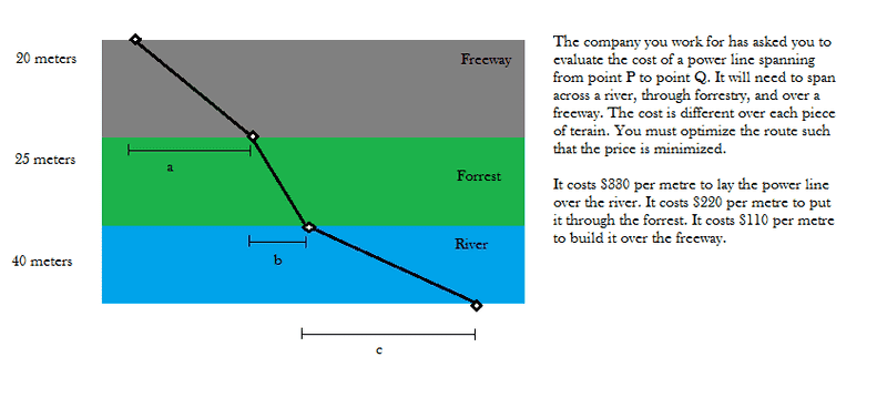

Optimization Problem, Laying down electrical lines (Multivariable)
2 replies · 2K views
WalkTex

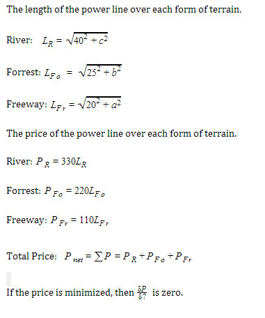

I am not really sure how to optimize it from here. What should I be taking the derivative of the price function with respect to ??
Your total cost function C is a function of three variables (a,b,c). What do you know about optimizing multivariate functions? If your answer is that you don't know how to do it, then you need to do some reading; either look in a textbook, or search on-line (for example, by using Google search words 'multivariable optimization' or something similar).
How far to the right is the point Q from the point P? Perhaps it doesn't matter, but you need to limit a+b+c to some value to work the problem. So you have an additional equation a+b+c =D. That will let you express the total price in terms of two of the unknowns a,b,c. Differentiate with respect to them.
