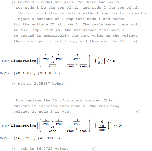

Two years ago you said in a post: https://www.physicsforums.com/threads/independent-study-for-linear-algebra.880866/
"Hello, I just completed a first course in linear algebra and really enjoyed my studies. So much so that I want to pursue it more in the fall as an independent study, i am a EE major in college and was curious what directions might be useful for applications in that field."
Here's how you could solve the current problem quickly using linear algebra. Using a calculator that can do linear algebra makes it very convenient.

  • #39
How did you think to do this? the matrix algebra aside, you could have still done these calculations by hand. Where does this method come from?
  • #40
The first thing I said in the demonstration is "Perform a nodal analysis." It's just a nodal analysis with the two nodal equations shown as the rows of a 2x2 matrix.
Oh that portion of your post was blocked out:
I don't remember using nodal analysis this way, interesting. Thanks!
