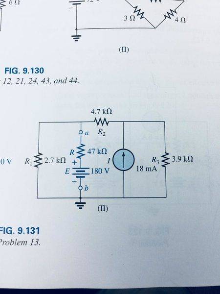

Find the Thevenin equivalent circuit for the portions of the networks in the following circuit:
Kirchoff's Voltage Law: ΣVdrops = ΣVgains
Kirchoff's Current Law: ΣIclosed loop = 0
Ohms Law: V = IR
Determination of the Thevenin Resistance is simple enough, Rth = 2.7 + ((4.7)(3.9)/(4.7+3.9)) = 2.05kΩ
The Thevenin Voltage is what's giving me trouble; if I measure the voltage across the terminals of the branch highlighted in blue how does the 3.9 kΩ resistor not experience any of this thevenin voltage?

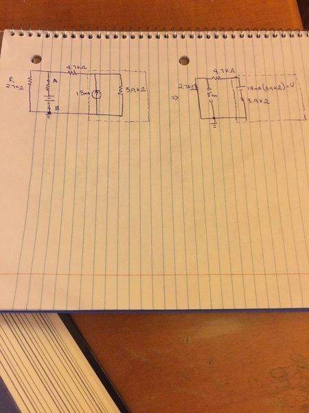

If we transform the current source by using ohms law so we now have a circuit with three branches. Does the thevenin voltage get distributed over the branch with the voltage source and the 3.9kΩ resistor? ?
That's not correct. Take another look at it.
I don't think you're using the word branch the way everybody else does. What do you mean the circuit has three branches?
I apologize, I can see that the network I used a source transformation on does not have that many branches.
Should it be 2.7 || ( 4.7 + 3.9) = 2.7 || 8.6 = (2.7*8.6)/(2.7 + 8.6) = 2.06kΩ = Rth?
That looks better.

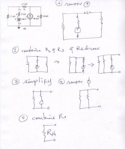

This is getting ridiculous. @icesalmon you will never get good at understanding these problems until you learn to redraw the circuit. Since you're new to it, I recommend step by step:
As you do the reduction, you do the calc's along the way and then you don't end up w/ any long confusing formulae, just simple ones as you go. Such problems are often, as this one is, drawn in a way that confuses beginners. This is done deliberately so that you DO learn to redraw.

The common problem with these explanations is that they are dealing with too much of the circuit at once to really be just the application of Thevenin/norton transformations. Thevenin/Norton is simply the change between a series voltage and resistance to a parallel current source and resistance. So, you would just work with a single source and a single resistance (or impedence for AC circuits) at each transformation; i.e. just a small piece of the whole circuit. Each transformation will convert (only) a single loop to a branch or a single branch to a loop. Then you can simplify the network by combining series/parallel elements of the same type, like two resistors into one equivalent resistor or two sources into one source. Then repeat the process: transform - simplify - transform - simplify, etc. until you have a very simple circuit to evaluate. At each step you are only working with two circuit elements.
DaveE said:
... just a small piece of the whole circuit. Each transformation will convert (only) a single loop to a branch or a single branch to a loop. Then you can simplify the network by combining series/parallel elements of the same type, like two resistors into one equivalent resistor or two sources into one source. Then repeat the process: transform - simplify - transform - simplify, etc. until you have a very simple circuit to evaluate. At each step you are only working with two circuit elements.
Gee, why didn't I think of that :smile:
