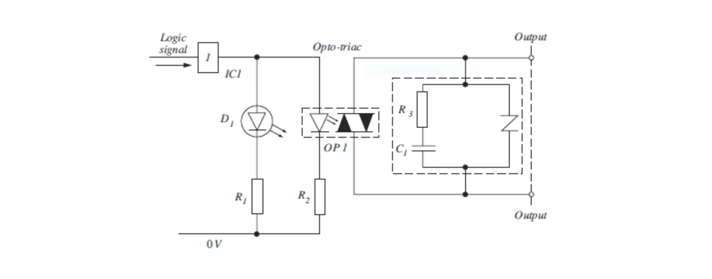

Referring to the opto-triac output circuit shown below.
Given the following parameters:
Logic voltage = 3.3 V
D1 forward voltage drop = 1.8 V
D1 operating current = 10 mA
Opto-triac minimum operating current = 2 mA
Opto-triac LED forward voltage drop = 1.6V
Calculate suitable values for R1 and R2, show all your working.

I am baffled. The example in the notes relates to a series circuit.
Calculating R1 and R2
If 3.3 V were connected, then both of these devices would burn out unless resistors limited the current to a safe value (10 mA?).
Therefore, these resistors need to drop (3.3V-?V) whilst carrying 10mA.
The circuit is parallel - So I am using the formula used for resistors in parallel and applying it to the voltage drops in parallel.
1/?V = 1/1.8 + 1/1.6
V = 72/85 V
Therefore, the resistors need to drop 3.3 - (72/85) = (417/170) V
R1 + R2 = (417/170) / 0.01
R1 + R2 = (4170/17) Ω
The switch current is 10 mA but only 2 mA is needed through the opto-isolator LED.
Therefore, 10 mA − 2m A = 8 mA will need to be removed by the use of R2 with a value:
R2 = 1.6/0.008
R2 = 200 Ω
So, R1 = (4170/170) - 200 = (770/17) Ω
You say you are familiar with series circuits and these circuits are in parallel. So far I agree.
How about if you think of each of the series circuits by itself, one at a time; even though they are in parallel with each other?
Pick one of them and let's see what the calculation is.

What would you say is the function of D1 in this circuit? Explain what it does here.
Ohm's Law says the value of a resistance is equal to the voltage across that resistor[/color] ÷ the current through it.
What value is the desired voltage across R1 in this design?
Likes Michael Neo
The purpose of the LED D1 is to show current is flowing?
If voltage drop across LED D1 is 1.8 V, then the voltage across the resistor is 3.3 - 1.8 = 1.5 V
R = V/I
R1 = 1.5/0.01
R1 = 150 Ω
Michael Neo said:
R1 = 150 Ω
That looks right. Now determine R2.
Likes Michael Neo

Michael Neo said:
The operating current is 10 mA
10mA is given for the current through D1, but I can't see 10mA specified for anything else.
You are given 2mA as the minimum current for the triac diode, so you could use that as the design parameter, or you might say, well, to allow a margin, I'll design for at least 3mA.

If the LHS circuit is a series circuit, 10 mA will flow through the whole circuit.
But it isn't a series arrangement. The driver supplies current to two diode networks in parallel, so each has a current independent of the other’s.
Likes Michael Neo
I thought Logic signal (3.3 V) was the only source of voltage in the LHS circuit.
It is.
Likes Michael Neo
If the LHS circuit is a parallel circuit, then the current in the other path needs to be calculated.
Is the LHS circuit, a series or parallel circuit?
If it is a series circuit, the same current will flow around it.
If it is a parallel circuit, the paths will NOT have the same current flowing around it.
The purpose of R2 is to reduce the current to the Opto-triac LEDs minimum operating current (i.e. 2 mA).
Therefore, it is necessary to calculate the current in that path THEN calculate the resistance required to achieve this reduction.
In a parallel circuit, the voltage drops across each of the parallel paths is the same as the voltage gain in voltage source.
If the voltage drop in the Opto-triac is 1.6 V, then the voltage drop in R1 must be 1.7 V (1.6 + 1.7 = 3.3).
I am baffled how to calculate the current in that part of the circuit.

I assumed that the current flows in an anti-clockwise direction.
However, the components indicates the current splits at the first node.
If so, then R2 doesn't perform the function outlined above.
The voltage across R2 = 3.3 - 1.6 = 1.7 V
So, R1 is simply:
R1 = 1.7/0.002
R1 = 850 Ω
The direction of the current is given in the diagram.
Current passing through a diode can only go in one direction, called the forward direction.
The diode allows current to flow in the direction of the arrow.
So, the current does split at the first node.
The current from the logic driver splits and travels to the 0v line via two independent parallel paths. Independent means independent, so the choice of current through R2 here has nothing whatever to do with the value of current through R1.

Then:
So, R2 is simply:
R2 = 1.7/0.002
R2 = 850 Ω
So, R1 is simply:
R1 = 1.7/0.002
R1 = 850 Ω
That may be sufficient for this exercise, but in practice you wouldn't design for operation right at the minimum, you'd go for a higher current to allow a margin for reliability. Further, you're not going to specify 850 ohms, you'll choose one of the preferred values.
Likes Michael Neo

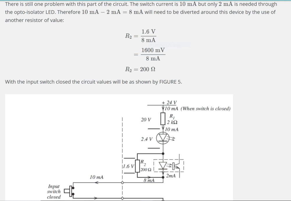

This is a very straightforward question:
(a) if you relax and read the diagram first and understand what is happening (especially the impact of the diodes on the direction of the current);
(b) because of the direction of current flow, the function of R2 is not the same as the example given in the notes.
What do you mean by "... you'll choose one of the preferred values"?
What does the example in your notes say is the function of the series resistor for the LED in the opto-triac?
Likes Michael Neo
In the example, the purpose of R2 is to reduce the current to the Opto-triac LEDs minimum operating current (i.e. 2 mA).
The operating current is 10 mA but only 2 mA is needed through the opto-isolator LED.
Therefore, 10 mA − 2 mA = 8 mA will need to be removed by the use of R2:
R2 = 1.6/0.008
R2 = 20 Ω
But the direction of current flow in the new question is different because there are two diodes in the LHS circuit.
Michael Neo said:
Therefore, 10 mA − 2m A = 8 mA will need to be removed by the use of R2:
It sounds as though that example involved a fixed current driver, not the fixed voltage driver shown in this exercise. Was R shown connected in series or in parallel with the opto-triac's LED in your notes?
Likes Michael Neo
