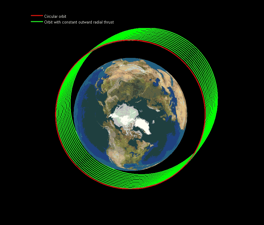

  • #31
After sleeping on it, the "orbit" pictured makes more sense. In an orbit, the satellite travels more slowly on the apogee side than on the perigee side. So what would happen on each "orbit" with our rocket is that the radial thrust would average more and more towards the apogee - thus propelling itself to ever higher apogees.
I will still do a sim.
  • #32
Given conservation of angular momentum and energy, it is immediately clear that neither apogee nor perigee can vary at all while the radial thrust is maintained. Yes, they will differ from the apogee and perigee of the original, un-thrusted orbit. But they must be constant from one loop to the next in the new, thrusted orbit.
Let me walk through that argument a bit more slowly.
At perigee, conservation of angular momentum dictates the tangential component of the velocity as a function of radius. At perigee, conservation of energy dictates the magnitude of the velocity as a function of radius. At perigee, the two must be equal.
That means that we can solve an equation for the radius at perigee. Same for apogee. Same equation. For a bound, non-circular orbit, it will yield [at least] two solutions.
One might look at the situation a bit differently, still without actually solving the equation. Consider the total mechanical energy of the satellite split up into three parts. One part is potential energy. Another part is the kinetic energy corresponding to the "tangential" component of velocity. That is, the component at right angles to the central direction. The third part is the kinetic energy corresponding to the radial component of velocity. Potential energy is a simple function of radius. Given conservation of angular momentum, tangential kinetic energy is also a simple function of radius. Once we factor in conservation of energy, radial kinetic energy must also be a function of radius.
For some radii, radial kinetic energy may be negative. That means that the radius is a forbidden zone. The satellite can never get there. Apogee and perigee are at the boundaries of forbidden zones.
An orbit is bound if it exists within a zone that is surrounded by a forbidden zone.
It might help to visualize a saucer with a series of concentric ridges and a marble rolling around in the trough between a pair of ridges. Or rolling within a central depression.

  • #34

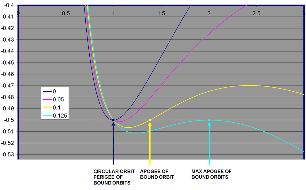

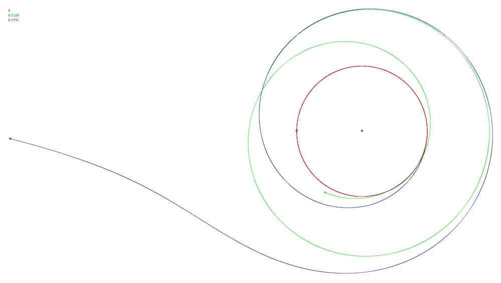

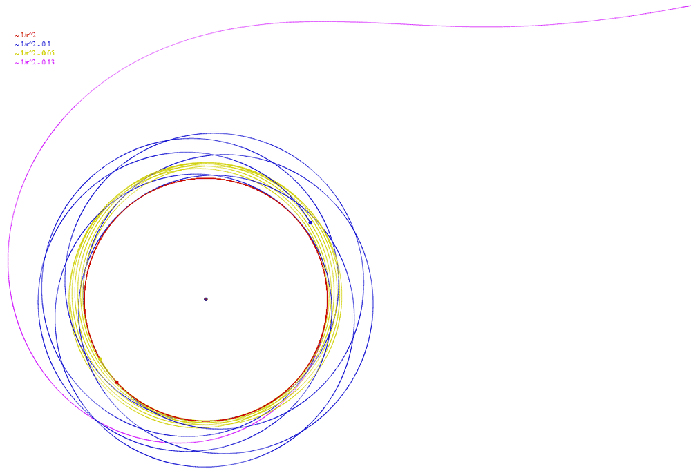

Constant in the sense of distance from the center, but they still can precess?
A quick test simulation gives me the following. The radial thrust is 0.05 (yellow), 0.1 (blue), 0.13 (pink) of the gravity at the initial circular orbit (red). Note that none of the trusted orbits goes below the initial radius.
Yes.
  • #36

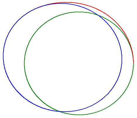

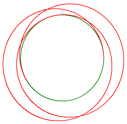

I just made some simulations.
In case of a thrusted orbit (red) the radius of perigee and apogee remain constant but they are rotating around the center:

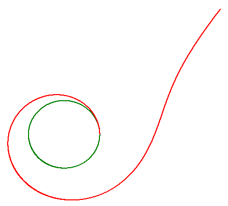

With too much thrust the spacecraft escapes:
As I already expected the thrusted transfer (red) results in a new orbit (blue) with perigee below and apogee above the original circular orbit (green):
So the shifting of the orbit and the crash on the planet happens for radial burn of a certain finite time. In this case the image below and its labeling is misleading

In my simulations the thrust needed to escape is very close to 1/8 of the gravity on the initial circular orbit. I wonder if it is exactly 1/8 and if there is a nice proof for it.

If you accelerate at exactly 1/8g, it will probably approach but never reach a perfect circular orbit at the apogee radius, never returning to the low radius like your green line. This is an unstable equilibrium, so your simulation probably will not show this unless it has infinite precision and infinitely small time steps.
As for the software, I know how to write my own simulations, but the nice picture output uses a library set with which I'm not familiar. I can't make pretty pictures like that, only tables of numbers and such.
  • #56
Halc said:
I suspect it is exactly 1/8.
Me too. I tried different radii and gravity strengths, and it always starts escaping a this thrust ratio to initial gravity. I guess to show this, one would modify the effective potential:

Another interesting parameter to explore is the apogee for thrust just below the critical escape thrust. Purely visually it looks like twice the original circular orbit radius.
This would fit the critical thrust of ##\frac{g_0}{8}##: At twice the initial radius, the tangential velocity is halved (AM conservation), so the centripetal acceleration ##\frac{v^2}{r}## required for a circular orbit is ##\frac{g_0}{8}##. Gravity itself is ##\frac{g_0}{4}##, but with ##\frac{g_0}{8}## opposite thrust the acceleration becomes exactly the value for an circular orbit.
That thursted circular orbit at ##2r_0## is unstable. With less than ##\frac{g_0}{8}## thrust you drop lower and gravity grows again (if you got to ##2r_0## somehow). With more than ##\frac{g_0}{8}## thrust you go higher continuously as gravity decreases.

In apogee the radial velocity is zero
##\dot r_a = 0##
Thus, orbital energy in apogee is
##\frac{{E_a }}{m} = \frac{1}{2} \cdot \frac{{g_0 \cdot r_0^3 }}{{r_a^2 }} - \frac{{g_0 \cdot r_0^2 }}{{r_a }} - a \cdot r_a##
I am looking for the apogee with the maximum energy. That means
##\frac{d}{{dr_a }}\frac{{E_a }}{m} = - \frac{{g_0 \cdot r_0^3 }}{{r_a^3 }} + \frac{{g_0 \cdot r_0^2 }}{{r_a^2 }} - a = 0##
Now I would need to solve this cubic equation (@jbriggs444 already corrected me in this regard) for ##r_a##, calculate the corresponding energy and than solve ##a## for equal initial energy. But fortunately we already have an idea for ##a## that just needs to be checked:
##a = \frac{{g_0 }}{8}##
results in
##r_{\max } = 2 \cdot r_0##
and
##\frac{{E_{\max } }}{m} = \frac{{E_0 }}{m} = - \frac{5}{8}g_0 \cdot r_a ##
That means the empiric estimates for ##a## and ##r_{max}## are correct.
