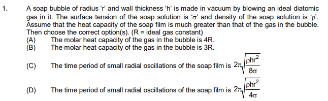

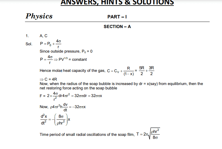

ok for more information, we were also asked the the molar heat capacity of the gas as the first part, i am posting the official question as well as the provided solution , why did you comment that i treated the system as isothermal, i am genuinely intrigued as solutions posted by the institute are incorrect sometimes

In your original solution you wrote the equilibrium equation ##P=4\frac Tr=4(\frac{4\pi}{3V})^\frac 13## and deduced that as it oscillates the pressure varies as V-1/3. That does not follow. Oscillation means it moves away from equilibrium, so ##P=4\frac Tr## does not apply.
You need to consider some small change in radius, x, how that affects the two pressures, and the consequent rate of change in x.
Let P=P(r). It helps to think of the surface tension as exerting a pressure Q(r)=4T/r. At equilibrium this balances the gas pressure, hence P(r0)=Q(r0)=4T/r0.
But when r increases to r0+x this pressure changes by Q'x, and the gas pressure by P'x. This leads to a net restoring pressure -(P'-Q')x.
The mass per unit area of the film is ##\rho h##, so ##\rho h\ddot x=(P'-Q')x##.
I would say a realistic model is adiabatic, so ##P∝V^{-\gamma}##, so ##P'=-3\gamma P/r##. Meanwhile, Q'=-Q/r.
##\rho h \ddot x=-(3\gamma-1)\frac {4T}{r_0^2}x##.
If you want to take it as isothermal then set ##\gamma=1##.

Ok, I have looked at the official answer and straightaway it is wrong. As I wrote, ##P∝V^{-1/3}## is a statement about equilibrium values, i.e. if you had a number of bubbles of the same material and thickness, all at equilibrium, that would be the relationship between their various pressures and volumes. It is not a statement about how pressure and volume vary as a given bubble is disturbed from equilibrium.
It does appear you are expected to take it as adiabatic, with ##\gamma=7/5##. So my answer becomes ##\rho h \ddot x=-\frac{64\sigma}{5r^2}x##.
