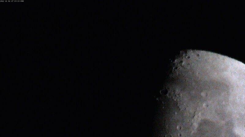

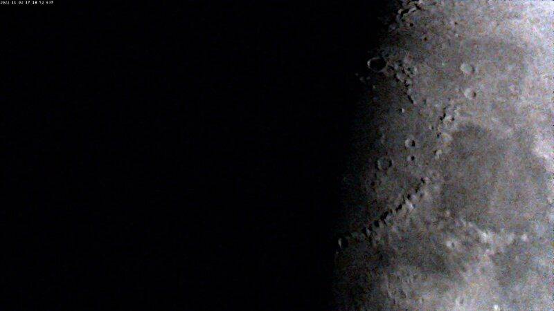

2.11. I made some pictures with my small telescope (Newton 600 x 100 mm) with eyepiece camera bresser from window (bad light condition of course furthemore already cca half moon was present)... last four images are Gimp corrected... :frown::smile:

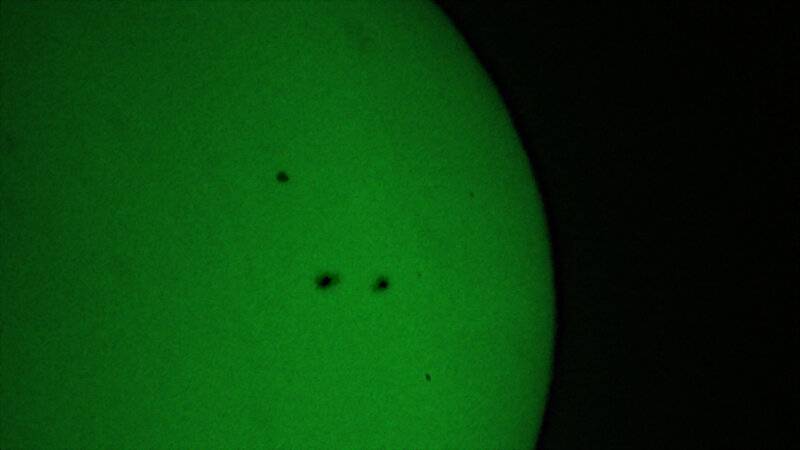

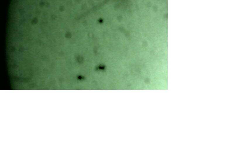

Hi, here is two images of three sunspots as I catch them 8.11.-image 1 is by SV Ebony camera 1.25"
and image 2 is by Bresser full HD deep sky camera 1.25" -with green filter both
lot of succes :smile: :confused:

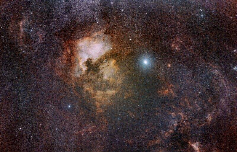

NGC 7822 captured from my back patio in October, 2022.
The portion of NGC 7822, as shown here, is part of a larger nebula commonly called "The Question Mark Nebula," that resembles a giant question mark ("?"). You can't see the question mark here because the image is "zoomed in" too much, so to speak. The image here is only the central region of the nebula.
It was difficult for me to process this image simply because there's so much going on in this region of space. I kept getting lost.

Hi, Saturn and Jupiter with 3 moons made by Newton 1000x200 mm and eyepiece camera SV EBONY
on Saturday , South Bohemia (countryside but with light pollution cca Bortle 6. im. with ---g are Gimp corrected. (I was not able more decreased Saturn exposition in order to see belts... :confused: :confused:)
Lot of succes:wink::smile:

Made by my friend (half professional photographer)':
The brightest star is Deneb from the constellation Cygnus, and to the left of it the Pelican Nebula and North America can be seen.
Technique: Sony A7, Samyang 135/2, SW Star Adventurer, UHC Astronomik filter
Exposure: 150x40sec
Post-processing: AstroPixelProcessor, PixInsight, Photoshop
