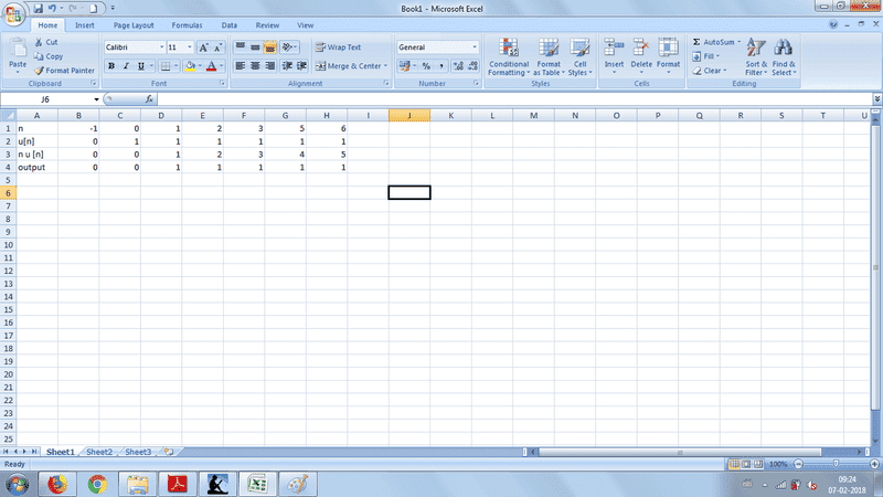

jaus tail
613
48
Find out the function of the system.
Apply that to input.
From given input output, system is a differentiator.
So when input is n u[n]
output is differentiating it,
we get:
n (impulse response) + u[n]
Which is not in any of the option.
Book answer is B.
I'm struggling to get that.

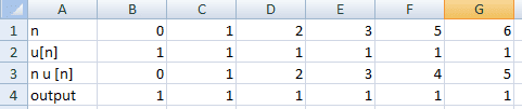

jaus tail said:
How to find the difference equation?
From quora I found:
difference equation of f(n) = f(n+1) - f(n)
Close, but not quite perfect.
The equation does involve a difference between a couple of terms. Just make sure to get the right terms.
But here input is n u[n]
so how to find it's difference equation:
(n + 1) u [n + 1] - n u[n] ?
Start by writing out the sequence of [itex]n u[n][/itex]. Start at around n = -3 and work you way to around n = 5 or so.
Yeah I think i figured it out. I was editing my post when you replied. Is it right now?
Yes, that looks correct now to me. :smile:
(Edit: you skipped the number '4' in your n, but you seem to have worked it out correctly otherwise.)
Also gives me right answer of B. Thanks.
