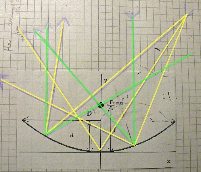

If incoming light to a parabola is parallel to the central axis the light is reflected through the focal point and the back to its source.
What about light coming in not parallel to the central axis. What path do these rays take?

No, it is not. It is reflected to the focal point of the parabola and if there isn't anything there to stop it, it spreads out in a wide cone, not reflected back to its source
That will be a function of the exact angle but it will be some kind of cone as it leaves the parabolic reflector, just not as symmetrical a cone as you get with rays parallel to the axis.EDIT: Ah ... I see that I am assuming a short reflector like a car headlamp or a photographers reflector and you are likely assuming a much longer one, in which case you are right although your statement leave out the significant factor of its hitting the reflector wall again and THEN being reflected back to the source. My short reflector isn't long enough for it to hit the reflector again, which is why I said what I said.

I used the focal point to determine the normal at each of the points where my source ray reflected of the parabola wall.
And the results are, as can be seen in my rough and ready image in yellow, if it hits the parabola walls twice it ends up parallel to the central axis. I almost didn't believe it.

You would have been right not to believe it. It is not true.
Trace that ray backward. It came in parallel to the axis of the parabola. Accordingly it must be reflected through the focus. Keep tracing it. It came through the focus, so it must be reflected parallel to the axis of the parabola.
A ray coming in from off-axis cannot reflect through the focus of the parabola. A ray leaving the parabola on-axis must have reflected through the focus. Accordingly, a ray coming in off axis can NEVER be reflected parallel to the axis, no matter how many times it is reflected.
EDIT: Exception -- a ray that comes in and hits the focus without first having been reflected.
If I trace the ray back and out through the focus then the angle of incidence and reflection aren't equal. Which must mean there is something very wrong with my parabola sketch, but I can't see it.
DaveC426913 said:
I am not familiar with how you constructed this shape. Are you sure it's a parabola?
It's actually a concave spherical mirror, I didn't know how to sketch a parabola, so I thought it was a good enough approximation.
Edit: i see that was a mistake

I can do that when I get home, but then is my ray drawing for the spherical mirror correct, where off axis light sources end up parallel to the central axis?
No, I think you likely just happened to hit a good case.
