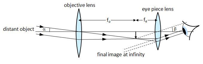

When you look up a ray diagram for a telescope you get the following:
From reading my book it seems clear that the objective lens forms and image on the focal plane. This then serves as an image for the eyepiece. Since the focal length of the eyepiece at the focal length of the objective lens you get a virtual image at infinity. Three questions have come to me:1) I didn't think you could get an image at infinity since the light rays do not converge?
2) Different sources tell me different things about the focal lengths. This source says right at the beginning that for a telescope the focal lengths actually overlap:
3) I really don't get why the image from the objective lens is sometimes in the focal plane as oppose to the focal point. In the diagram above the light rays (although parallel) come in at some angle to the principle axis. When could this ever happen because surely you just point your telescope straight at the object you are looking at in the sky so that the rays will always be parallel to the principle axis? But then if they did am I right in saying that you would get no image as the rays would all converge to a point right at the focal point?
Thanks for any help given!

the image formed by the objective lens is the OBJECT for the eyepiece lens.
The parallel rays entering the objective are from the top of the object at infinity. Look at the arrow which is the image. The base of the image is at the focal point. This is the point where rays parallel to the axis meet.

Thanks. I understand all of that what I don't understand is the FINAL image after the image formed by the objective lens has gone through the eyepiece. If you trace back the rays from the final image they do not converge and it says that the image is formed at infinity - is they do no converge and form an image at infinity then how does this form an image?
The rays enter your eye and the eye makes them converge on your retina. Because the rays were parallel when the entered your eye, the image appears to be an infinite distance away. But really, when we say the image is 'formed at infinity' we just mean that the rays from any point on the image are parallel/near-parallel. A star that's 5,000 light-years away doesn't actually emit rays parallel to themselves, but they are so close to parallel that we can treat them as parallel for almost all purposes.

Thanks, you have been very helpful. If the rays enter the eye parallel and the image is at infinity then surely you haven't magnified the image? So what is the point of such a set up? If you actually do get an image under these conditions then how would you draw it on a ray diagram such as the one in my original post.
One other thing that is really bothering me is when people say that the eye sees objects coming from the same line of sight as the rays entering the eye. This explains refraction as shown in this diagram:
However, the eye will converge the rays shown in this diagram onto the retina as you say. Am I therefore correct in saying that light enters your eye, gets refracted by your lens onto the retina which relays the message to your brain. Your brain is able to infer the location of the object BEFORE the light got refracted by the lens and does this by assuming that it came along the same line as it entered the eye whether or not this is the case (as it wouldn't be in the case of refraction). It just seems weird that the message to your brain gets sent after refraction from the lens but it can tell the location of the object using information before it got refracted?

This may be obvious but it has to be said; the purpose of a telescope is to Magnify the angle between two distant points (two point stars or two sides of a resolvable object). only a small proportion of rays come directly along the principle axis and the rest arrive from a bit to one side (perhaps only minutes of arc). Diagrams of telescopes exaggerate the angles so that you can actually see the plotted rays. The magnification in a simple telescope is given by the ratio of the focal lengths of the objective and eyepiece lenses. A magnification of only 60X will take an pobject that's 1minute of arc and give you an image that's still only 1 degree wide. You would need to be pointing pretty damn close to an abject in order to see it because the field of view is so small. Perhaps that explains your dilemma?
Whether the rays enter the eye parallel to themselves or not is a matter of focus, not magnification. When focusing a telescope you are supposed to move the eyepiece in or out until the rays enter your eye parallel to each other. At this point your eye doesn't need to use your lens to focus at all since the image seems to come from infinity. If you move it to a sub-optimal position, you have to use your lens to focus the now diverging cone of light onto your retina, which leads to eye strain and causes the image to seem as if it is closer than infinity.

Thanks again! In ray diagrams I have seen you physically trace the rays back until they converge and you then get the size and orientation of the image. For example:
Why can't you do this for the one I posted at the start? Since the image formed by the eyepiece will be bigger than the one formed by the objective lens wouldn't it?
Yes. In fact, I can easily change the magnification of my telescope just by changing out the eyepiece. Note that a telescope, consisting of an objective lens and an eyepiece, is a complex optical system, not a simple one like a magnifier. The object the eyepiece is viewing is actually the image formed by the objective lens. The eyepiece acts as a short focal length magnifier for the image produced by the long focal length objective. Since you typically focus the telescope so that rays entering your eye are nearly parallel you can't just trace the rays back to their point of convergence (since there isn't one for parallel rays).

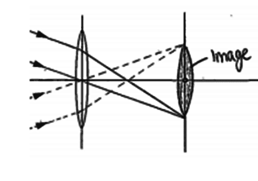

Would someone be so kind as to check an answer for a question we did in class (well actually I answered the question and its more of an extension of the question I was wondering about). We had to answer this question:
And my answer (which was correct) was:
But am I right in thinking that this is the image from the objective? Is it actually an accurate situation - can you get light coming from the top and bottom like this? I was wondering how you would go about drawing the rays through the eyepiece if I was ever asked. Would it be something like this:
That's right.
Absolutely. If you put a camera sensor at the focal plane of the objective, the light would be focused directly onto the sensor's pixel array. That it exactly how prime-focus astroimaging is done.
Yes it would be. This matches the diagram you posted in your first post.
Yes, more or less. The real intermediate image will extend on either side of the principal axis (as you have drawn) and the virtual, final image will appear to be where those final pairs of rays ( appear to be diverging from (draw dotted lines, extending way over to the left) at infinity and subtenting a much greater angle. But it isn't necessary to have an image extending either side of the axis- it is sufficient to go from the axis to one side. After all, that would only corresponding to pointing the scope slightly up or down.
While true, I'd like to point out that the 'image' will consist of anything within the field of view of the telescope, not just a single object. This seems so obvious as to make mentioning it pointless, but I feel many people are too deep down into the details to realize it when they first start studying optics.
Agreed. In an astronomical telescope the 'object' will often be two stars, next to each other. The magnification factor will apply to that separation or that of any two parts of the input field. The nice thing about an 'Arrow' to denote an object or image in optics is that it is independent of what the actual object might be.
