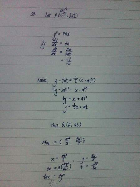

I'm pretty sure you're right.In summary, the variable tangent at P to the parabola y2=4ax meets the y-axis at Q. The equation of the locus of the midpoint of PQ is 2y2=9ax, which is confirmed by independent work.

A variable tangent at P to the parabola y2=4ax meets the y-axis at Q. Find the equation of the locus of the midpoint of PQ. As shown below, my final answer is 2y2=9ax but the answer provided is y2=9ax. Can anyone correct me?

Its a very good website... but would you kindly help me with my question first?? ><''

If it's any help to you, I worked it myself without looking at what you did and I got the same answer you did.
