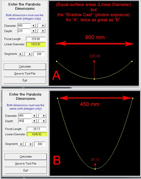

My understanding is that the amount of heat energy a parabolic reflective surface generates is not the volume of surface area of the mirror, but essentially the volume of surface exposed perpendicular to the suns rays. This effective surface can be also described as the area of shadow that is cast by the mirror. Example: A very deep conical parabolic mirror has a linear surface area of 1000 but casts a shadow of 500, while a flatter parabolic mirror has a linear surface of 700, but casts a shadow of 600 . The smaller parabolic mirror gathers more photons with the larger "shadow".
I've attached an example of two configurations with equal linear amounts, but with unequal exposure.
Can someone comment on this? Is my above assumption correct? and a second question ... can photons be compressed?

You are right. It's called the aperture. And, assuming the parabolic mirror is doing its thing, the size of that aperture determines the amount of light that is collected and focused.
As for "compressing photons": except in very extreme conditions, photons do not interact with each other - so the limit to how many you can have in a specified volume is generally limited to how many you can get in there at the same time without frying something.
Depending on the circumstances, there are limits to how precisely you can focus photons to a small area.

What I do know is that photons are not relevant to it. Those are used for a quantum mechanical description of light. This is an engineering problem. A classical picture of light with ray optics is plenty good enough.
As a first approximation, conservation of energy will tell you that a trough width of sunlight reflected onto a tube width of tube will give you the full energy times the reflector efficiency times the tubes absorbance efficiency. I would expect the reflector efficiency to be a large fraction of 100% and the absorbance to be a somewhat smaller fraction of 100%.
Then you start dealing with how absorbance depends on angle of incidence and tube temperature and how much heat is wasted in radiation, convection and conduction.
A graph of temperature versus time and knowledge of the thermal mass of the tube might let you determine some of the parameters pretty well.

This (using photons) is not a fruitful way to approach the situation. In free space, you can 'concentrate' a light beam as much as you like. (Remember, it will always spread out again past this focus). That is because space can be looked upon as linear and electromagnetic fields in space do not interact. If you focus light in any medium (even air) the EM radiation will interact with the medium and there is a limit to the Power Density in a region, after which the air will ionise and form a spark (plasma).

There's a free software Parabola Calculator 2.0, that generates a DXF to Auto Cad, and from there its modeled in 3D Studio Max. But the focal line of light on the target is remarkably tight, generating it with that. Our metal "monster" my fabricator made was cut with a DXF and water jet.
If I could learn how to calculate for a trough parabolic, the length of "wings" (diameter), the length and diameter of copper, and the flow rate to maintain 200C. I'd be a happy camper!
