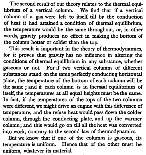

It is a fun for me to find in the reference that Maxwell explained clearly in his Heat Theory p.330

Yes, I came across this result in the Wikipedia article. It is the same argument as the one from the initial post:
Petr Matas said:
The upper and lower walls are black on the inside, so they are in thermal contact mediated by radiation (the gas is transparent). Their temperatures should therefore be equal,
I would like to reach the same result using statistical mechanics.
