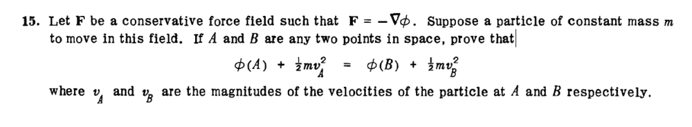

Printed textbook problem 15: a conservative force field F = -grad phi acts on a particle of constant mass m; prove phi(A) + (1/2)m v_A^2 = phi(B) + (1/2)m v_B^2 for any two points A and B.

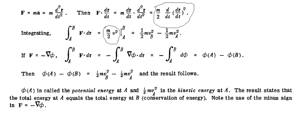

Handwritten-style derivation of conservation of energy: F = ma = m d²r/dt², then F·dr/dt = m (dr/dt)·(d²r/dt²) = d/dt(m/2 (dr/dt)²), integrated to ∫F·dr = ½mv_B² − ½mv_A², and with F = −∇φ, φ(A) − φ(B) = ½mv_B² − ½mv_A².
I don't get why ##F \cdot dr = \frac{mv^2}{2}##
I know this has to be really easy but don't see it.

What is the derivative of ##\vec v^2## with respect to time?

I see what you mean but that is the vector and not the magnitude
No it is not. ##\vec v^2 = \vec v \cdot \vec v = v^2##.

I think the author intended to use
## F= \frac{m}{2}\frac{d(v^2)}{dr}##.
It comes from the definition of force
##F=m\frac{d^2r}{dt^2}=m\frac{dv}{dt}##
as ##v=\frac{dr}{dt}##.
Applying chain rule when using derivative with respect to r instead of t:
##F=m\frac{d v}{d r} \frac{d r}{d t}=m v \frac{d v}{d r}=\frac{m}{2}\frac{d(v^2)}{dr}## .
