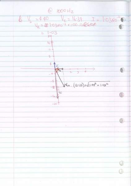

I'm struggling to figure out what vectors I use for my phasor diagram for an RLC series circuit.
VC = 1/j[tex]\omega[/tex]C
VL = j[tex]\omega[/tex]L
VR = IZ
I know how to add vectors, so that's not a problem, transfer my circuit from the time domain to frequency domain. I understand that VC leads the current and VL lags the current by [tex]pi/2[/tex] radians.
If I have say, r[tex]\angle[/tex][tex]\theta[/tex] as my input voltage, then I can draw that on my phasor diagram because it is given to me as a vector (easy). In contrast, VC, VL and VR are not vectors because after transferring them to the frequency domain, their unit is [tex]\Omega[/tex] which I think is a scalar quantity.
My question is, how do I get a vector out of VC, VL and VR in the frequency domain to plot onto my phasor diagram?

For the series RLC circuit, the current is common to all of the elements, so use that as your reference. At an instant in time, it will have some amplitude and phase. Using Ohm's Law, you can calculate the amplitude and phase of the voltage across each element at that instant in time. Those are the phasors that you draw on your diagram. Their vector sum then equals the source voltage.

Can you please check if I'm on the right track? It looks good to me.
http://img585.imageshack.us/img585/117/55843578.jpg
You've made several minor errors, but you're getting there. One error is that you left the factor of π out when calculating ω. Also, the sign of ZC is incorrect. You can't just bring the j up from the denominator to the numerator. Finally, I'm not sure where you got X from, but the value you used for X is not consistent with your other calculations.
When you, for instance, calculate the voltage across the capacitor, don't write V=IR when you really mean V=IZC. It's sloppy and, from a mathematical perspective, plainly wrong. It's obvious what you mean, but it's the kind of thing that can annoy some instructors and graders.
The more serious conceptual error is that you're not keeping track of the phases correctly. In the frequency domain, the voltages, the current, and the various impedances are all complex values, related by Ohm's Law:
[tex]V = I Z[/tex]
This equation concisely expresses the relationship between both the amplitude and phase of all the quantities. The equation
[tex]|V| = |I| |Z|[/tex]
is similar, but it only accounts for the amplitudes. In your calculations, the impedance you calculated is actually |Z|, not Z. So when you wrote that the current I is V with a phase divided by |Z|, that's not really correct. It's evidenced in the fact that if you add up the individual voltages you calculated, you'll find they don't add up to 12 V with phase of 0 degrees as it should. That's because the current I you calculated is missing the phase information.

I've made some corrections, but now I have more errors :(
With my new values for VC and VL, if I add them, they add to negative 12, which can't be right because I have a negative magnitude.
http://img854.imageshack.us/img854/338/74199395.jpg
The reactance X of an element is just its Z without the factor of j. The impedance of the circuit is
[tex]Z = Z_R + Z_L + Z_C = R + j\omega L - j\frac{1}{\omega C} = R + j\left(\omega L - \frac{1}{\omega C}\right)[/tex]
Note Z is a complex quantity. If you find the modulus of Z, you get
[tex]|Z| = \sqrt{R^2 + \left(\omega L - \frac{1}{\omega C}\right)^2}[/tex]
The Z you calculated is actually |Z|. It doesn't contain phase information any more, which is why you got the puzzling results where everything had 0 phase.
The current I you calculated is actually |I|. It's the amplitude with which the current oscillates. Similarly, you found |VL| and -|VC|. (The minus sign for VC indicates that VC lags the current by 90 degrees.)
To find the phase, what you want to do is draw the phasor diagram with VL, VC, and VR. |VL| and |VC| are the lengths of two of the vectors. The vector sum of the three voltages then equals V of the source.

I tried the second method you mentioned using my results from the link above. I think what I've done is correct. I'm not sure if I'm missing any more information
Although it isn't to scale or in a presentable format, I think it's all there.

Thank you very much for your help. My lab report is now complete and ready for submission :D
Also, a side question, in the lab report, he asked us to provide two phasor diagrams. One for 1000Hz and another for 3000Hz. They both appear to be roughly 1KHz above and below the resonance frequency which I calculated to be 1930.04 Hz. Apart from the relationship of the phase between the elements, I'm not sure what I'm supposed to learn from the two phasor diagrams.
Heres the second phasor diagram I did. As before, it's not to scale or in a presentable format.
http://img813.imageshack.us/img813/7845/82891587.jpg
