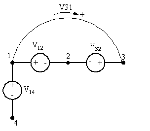

Several of the voltages associated with a certain circuit are given by V12=9∠30° V, V32=3∠132° V, V14=2∠10° V. Determine V21, V13, V34, and V24.
I am just using this problem as an example as I have no idea how to go from phasor to complex. So V13=V12+V32=9∠30°+3∠132°=? I don't really know here I can only imagine Magnitude*cos(θ)=Real and Magnitude*sin(θ)=imaginary I know this but how do I ultilize these beacuse everything I have done does not work?

To keep things straight I'd suggest creating a little circuit fragment containing the "known" points and their given potential differences. Something like:
The voltage supply polarities reflect the subscript convention, namely Vab would be the potential at a with respect to b, so that by convention a is where your meter's "+" lead would go and b would be where the "-" lead would go, if you were to make the measurement Vab. The actual values assigned to the supplies may be positive or negative depending upon what you're given.
Then, to find any potential difference between points, perform the "KVL walk" between them and sum the potential changes.

so for V13=V12+V32
DODGEVIPER13 said:
so for V13=V12+V32
By convention V13 would be the potential at 1 with respect to 3. So start at 3 and "walk" to 1. Pay attention to the polarities of the sources along the way.
Ahhh woops V13=V12-V32

I think you're still tripping over the directions of the potential changes. If you calculate a new potential difference, like V31, add a new branch to the diagram with the appropriate label and source direction. You can just use arrows to indicate polarity if the diagram starts getting too cluttered.
So for V34 you would start at V4 and walk through +V14 and +V31, right?
ok well V31=V32-V12=-9.801-j2.271
then V34=V14+V31
-7.831-j1.923=V34 hopefully?

V24=-V12+v14 = -5.824-j4.152
