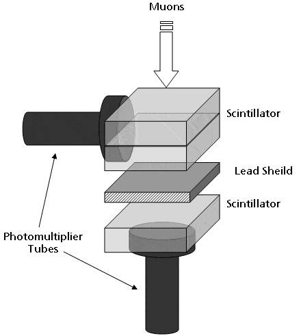

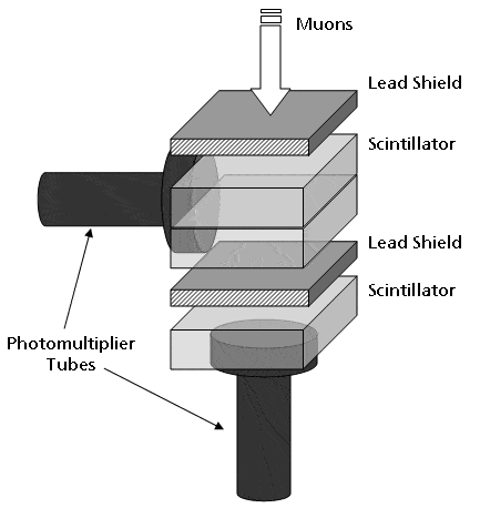

Here is a rough sketch of what the detector may look like, working with what I have available.
The http://www.hardhack.org.au/files/BC412.pdf" block measure 89mm x 89mm x 38mm and respond to an energy between 100 KEV to 5 MEV and emits light between 420nM and 450nM
The scintillator blocks will be coupled using Dowel Corning DC4 and the photomultiplier are a http://www.hardhack.org.au/files/s83020f.pdf" sensitive to light between 350nM to 500nM.

You are going to need some shielding at the top if you want to be monitoring cosmic ray muons. Otherwise you will be swamped with single hits. It doesn't have to be lead - it may be easier to get steel or brass.
I think you are going to be unhappy with your scintillator geometry. It's surface area is very small - you'll only get a fraction of a Hz of cosmic rays, and it's thicker than it needs to be. The more typical geometry is that of a large "paddle": say 100 cm x 10cm x 1 cm.

I'm not so sure. Your count rate depends on a lot of things - geometry, shielding, quantum efficiency, etc. Nonetheless, a good guess would be 0.05 Hz. Your singles rate from the tube is also hard to estimate, but you probably have several hundred Hz from thermionic emission alone: call it 1 kHz.
So you're starting off with a signal that is 20,000 smaller than your background.
Coincidence will help, of course - if you have a 50 ns window, that will reduce your background rate to 0.05 Hz: the same as your signal rate.
The actual numbers are there just to set the scale - your problem is that you expect accidental coincidence rates comparable to your cosmic ray rate. How can you tell you are seeing cosmic rays?
This is one reason people go to big counters - the tube noise rate is independent of size, but the signal grows as surface area.

The reason you want shielding is so that a) soft particles don't cause a signal and b) so you don't have a Compton electron leave one scintillator and enter another, giving you a false coincidence. You don't need lead, and you don't need much thickness, but you should use something. I've had good success with thin (~1/8" maybe) sheets of brass.
It will take some experimenting to get the right light output from quinine. I know the solution needs to be slightly acidic, but I don't know what the right concentration is. If it were up to me, and I couldn't just buy quinine, I'd start with diet tonic water (no sugar), and experiment with a UV lamp to try and get the solution with the right brightness.
Thank for the tips I have some uv lamps I'll give it a try, make a good blog. Tonic and cosmic rays.:cool:
I guess I could custom make up some brass boxes to enclose the scintillators, I have some brass sheet in the workshop.

For shielding between scintillators, the photon attenuation coefficient in lead at 1 MeV is about 0.07 cm2/gram, or 0.791 per cm. so you really want ~ 3 cm minimum of lead (or equiv nonmagnetic material) between the two scintillators to minimize accidental coincidences from correlated events (Compton scattering, etc.).
Cosmic ray (muon) energy loss in scintillator or water is about ~ 2 MeV per gram/cm2 (Bethe-Bloch ionization). Here is an estimate of signal yield per cm of radiator. Muons originate in proton hadronic cascades via pion decay in the upper atmosphere, and have a range of about βγcτ meters before decaying (β and γ are the usual relativistic parameters, c = 3 x 108 meters/sec, τ = 2.2 microsec.) before decaying. Some reach the ground.
