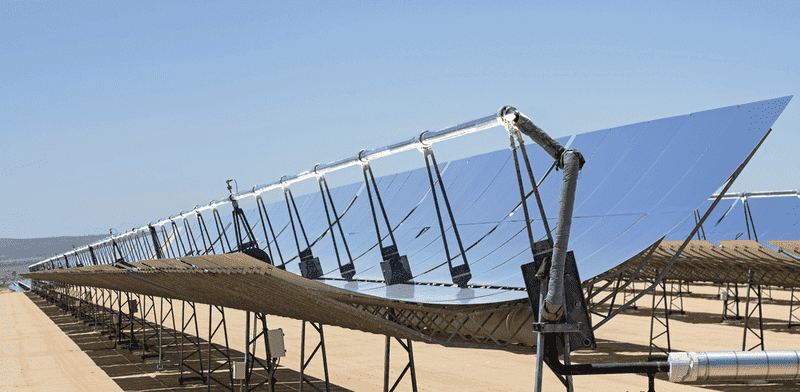

Here is an example of focused solar hot water panels.
Hi A,
This is better than my lens idea, it looks like it doesn't need to move to stay in focus?
I wonder why the collector tube isn't black?
C

Focused solar thermal panels have been well researched, well engineered, built and operated. Yet they are rarely seen today. What message does that suggest?
Hi A,
It could mean that it isn't practical, or that they haven't figured it out yet.
C
