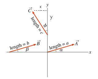

Find the components of the vector \vec{C} with length c = 1.00 and angle \phi = 30.0^{\circ} as shown.
opp=hypcos(\theta)
adj=hypcos(\theta)
tried to use the above equations to answer the question, however when i looked in the answers it was incorrect.
Answer i got was x=0.866 and y=0.5
When i realized that it was between the vector and the y axis, i found that the angle didn't make contact with the x-axis, so my question is What is the angle that \vec{C} makes with the positive x axis?

Hi Paymemoney! :smile:
Paymemoney said:
opp=hypcos(\theta)
adj=hypcos(\theta)
erm :redface: … they can't both be right, can they? :biggrin:
Start at the positive x-axis, go round to the y-axis, then go round some more … that's your angle! :wink:
But the main thing you've done wrong is that the dotted line marked "x" on your diagram isn't x, is it? :smile:

ok so i got 600 degrees, what is the next step i should take to solve \vec{C}

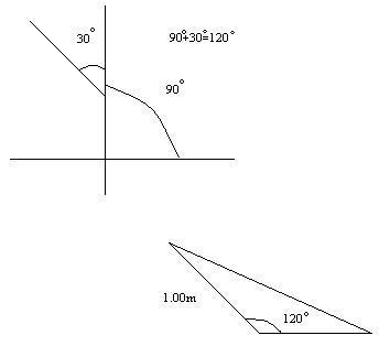

(have a degree: º and a theta: θ and a phi: φ :wink:)
Paymemoney said:
ok so i got 600 degrees …
hold it!
however did you get 600º ? :confused:
well i went around the the axis 2 times o_o
Still not 600º. :confused:
Anyway, just go from the x-axis to the y-axis anticlockwise, and then carry on to C.
ok this is what i have done:
tell me if this is correct.
Yes, that's exactly correct. :smile:
The "first quadrant" (top-right) is 0º to 90º, the "second quadrant" (top-left) is 90º to 180º, and so on. :wink:
