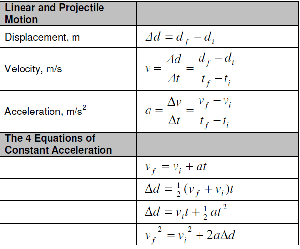

Hello I need help on the following problem:
A swimmer heading directly across a river 200 m wide reaches the opposite bank in 6 min and 40 sec she is swept downstream 480 meters, what is the velocity of the current?
v = ? ; t = 6 min 40 seconds
Dx = 200
Dy= 480
well I basicaly used the formula for velocity ( which is V= delta d/ delta t)
so I plugged in the numbers and converted time into 400 seconds and divided by 680 and ended up with .588
the answer is given, but its the work that matters
MY solution: .588 m/s
auctual solution: 1.2 m/s
can someone tell me where I went wrong?
Break the motion into an x and y components. We'll say the swimmer undergoes a displacement of 480 meters in the +x direction. The time it takes for this to happen is 6 minutes and 40 seconds (400 seconds). So 480/400 = 1.2 m/s. Remember, the key to solving this is thinking about the problem in components, one where the swimmer swims at his/her speed (which doesn't even apply in this problem) and one component in which water is propelling the swimmer.
so the 200m is ignored?
Yes.
