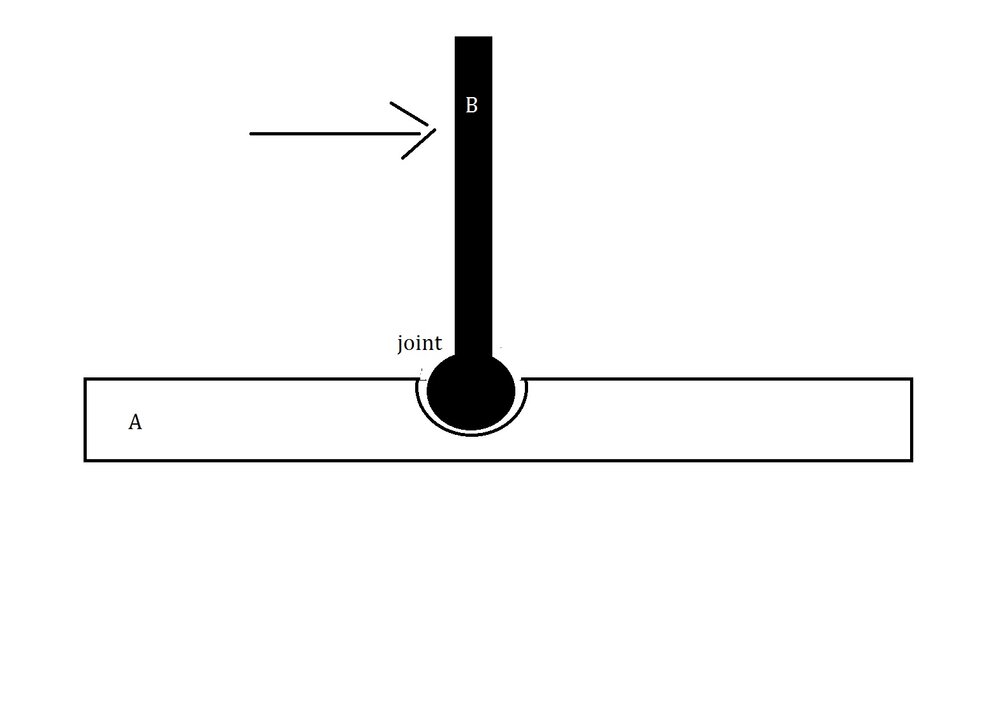

It's hard to see what the problem is here.
If you look at the complete surfer/plank/system, there's a couple that would press the nose down, from the wind force and the drag, and there will have to be a couple from gravity + buoyant force in the opposite direction.
If you look at only the plank, there can't be a large net torque on it from the sail and the surfer for two reasons.
1. there is indeed no way for such a torque to be exerted on the plank. (unless you stand before the mast in a tailwind and push against the sail).
2. The only way to counteract such a torque, would be for the nose to go deeper in the water and for the buoyant force to act further forward. This is undesirable. You'd flip forward at higher speeds.
So the surfer will have to stand or lean backwards to counteract the torque from the sail.

As I told you in post #3 already, you have to decide if you are analyzing the moments on the whole system or just on the board.

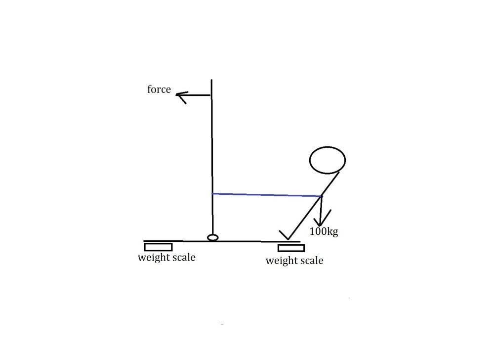

Today I make some calculations ,it seems that is impossible to press nose down if harness lines/hands are 100% horizontal.That math say..
Sailor must transfer some of his weight to the sail/mast foot to press nose down,but that is only possible if harness lines /hand have some downward angle...
So it seems popular "mast foot pressure" explanation is correct..

I do math and there is no mast foot pressure if lines /hands are 100% horizontal.
If you put lines more vertical,you can hold more sail power ,so drive force increase which has effect on system..
In same manner it is easier to hold falling tree if you attached rope at top instead at bottom of tree..
isnt it?

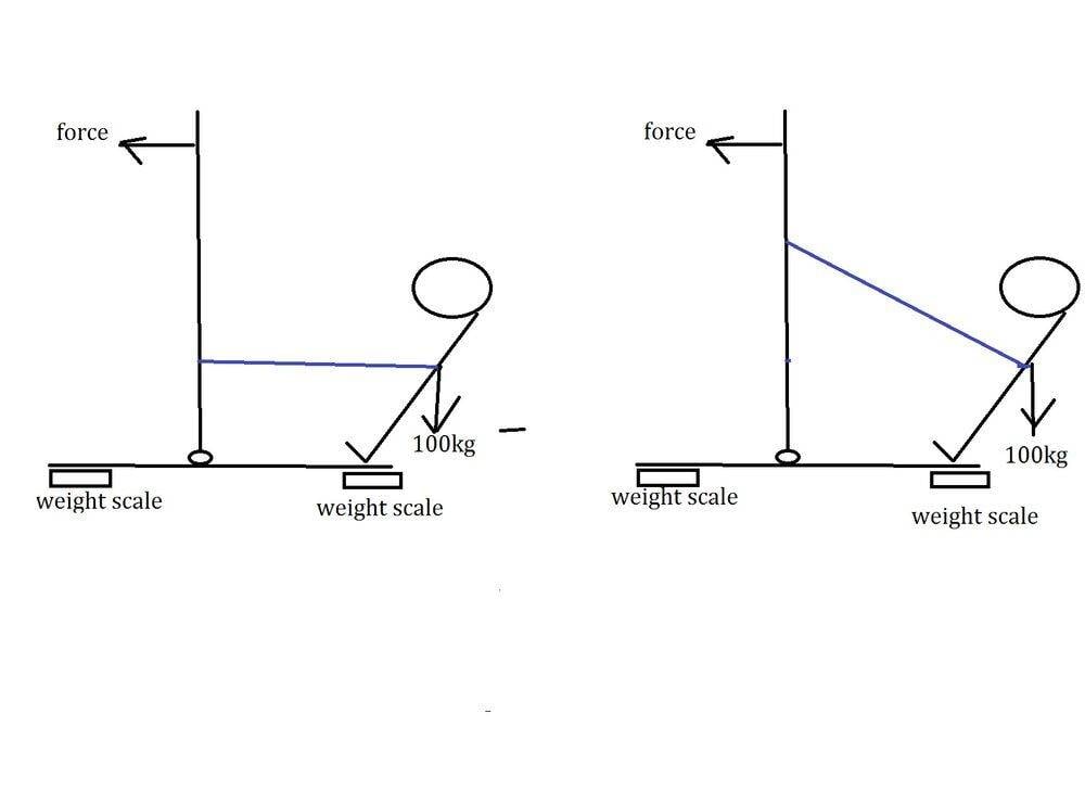

  • #45
John Mcrain said:
Are you sure in that?
if you have massless beam,and man with 100kg lean back like on picture,and horizontal drive force.
In case lines are horizontal ,left weight scale will allways show 0 kg,right weight scale will allways show 100kg
(left weight scale showing 0kg is "indicator "that nose is not press down)
If lines has downward angle ,left weight scale will allways show weight greather than 0kg,right scale will show less than 100kgView attachment 279038
If the force on the upper mast and the center of mass of the man are the same, the readings of the scales will also be the same.
  • #46
Sure? If the mast is placed over the left scale and the vertical force acting on the man cancels his weight, than the left scale should read 100 kg and the right 0.
  • Skeptical
  • #47
There are 4 external forces on the whole system. If sail force and weight don't change (same vectors and points of applicaton), then neither will the two scale forces change.

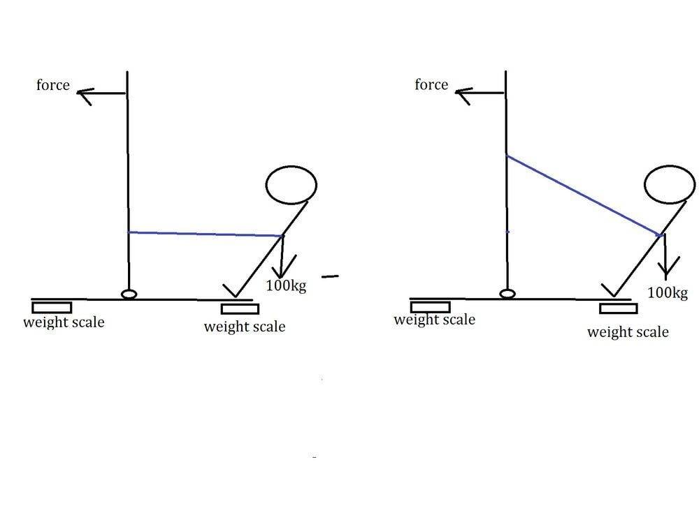

In post #44 I just want to prove that @jbriggs444 is wrong when say that harness lines/hands angle is irrelvant .
If lines are horizontal,left scale will allways show 0kg,that mean you can't press nose down with horizontal lines/hands.
  • #56
What are you compare ,left and right picture?
Force at mast at right picture,must be greater then on left(if everything else/geometery and sailor mass are the same,except lines angle),because lines are attached higher at mast..
So forces at mast can't be same in left and right picture..
  • #57
A.T. said:
I was replying to post #44. Nothing in that post suggests that the "horizontal drive force" (on the mast) is different for the two cases, or that the center of mass has moved.
You must see without any calculation,that "horizontal drive forces" at masts must be different,becasue line on right picture is connect at higher point,so right drive force is greater then left...
  • #58
If the force at mast changes, while the center of mass remains the same, the scale forces will change as well.
  • #59
You need to specify what you are holding fixed and what you are allowing to vary.
If you hold the wind force on the sail constant and hold the position of the surfer's center of mass constant but vary the angle of the line while requiring the system to remain in equilibrium then the line tension must change. The resulting scale readings will not change in this case. [The line tension can change if the surfer adjusts posture and foot position while leaving his center of mass stationary]
If you hold the line tension and the position of the surfer's center of mass constant but vary the angle of the line while requiring the system to remain in equilibrium then you must be varying the force of the wind. The resulting scale readings will change in this case.

Force at mast and harness line(blue rope) must be horizontal and system must be in equlibrium.
(catapult is not equlibrium)
Everything else you can change if you want,lean back angle,distance from joint to feet,weight but provided that force at mast and harness line are horizontal...
Tell what will left weight scale show? If you think that left weight scale can show number that is not 0kg,explain how..
I tell left weight scale will allways show 0 kg...
