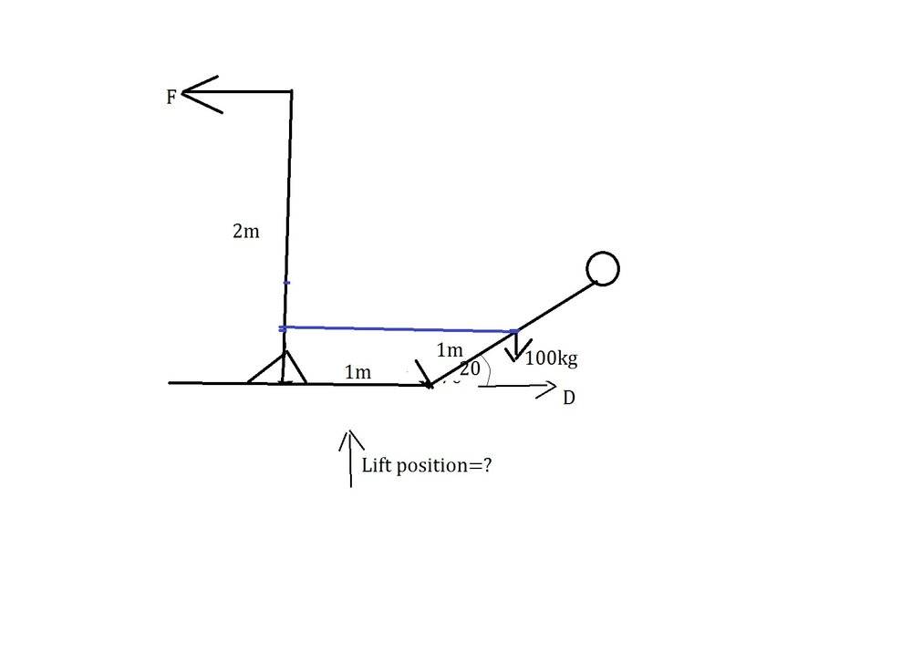

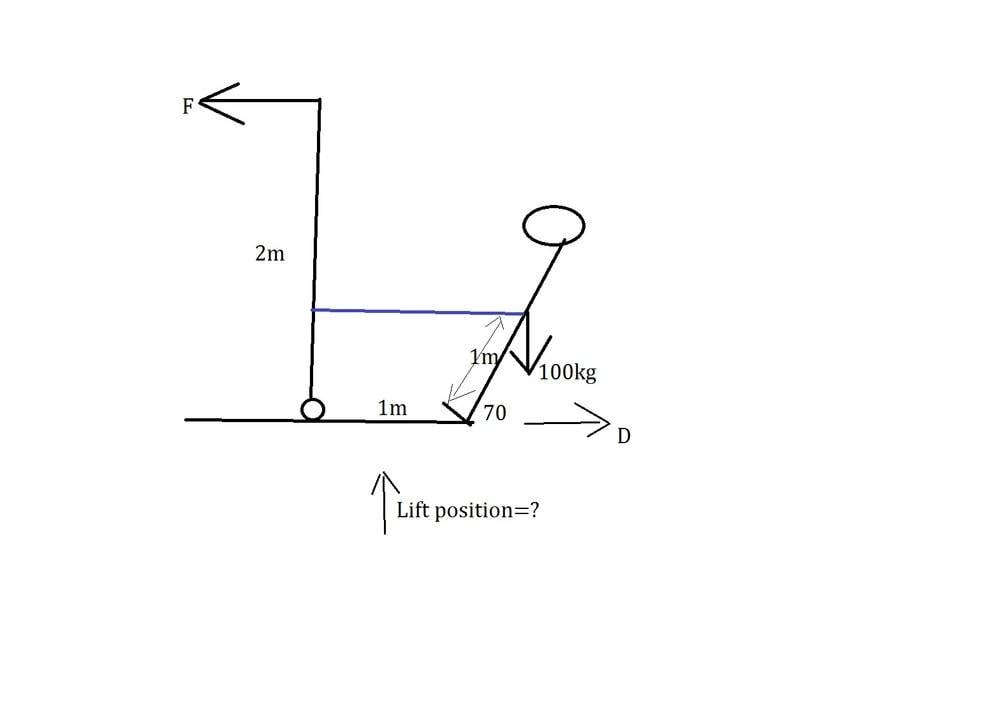

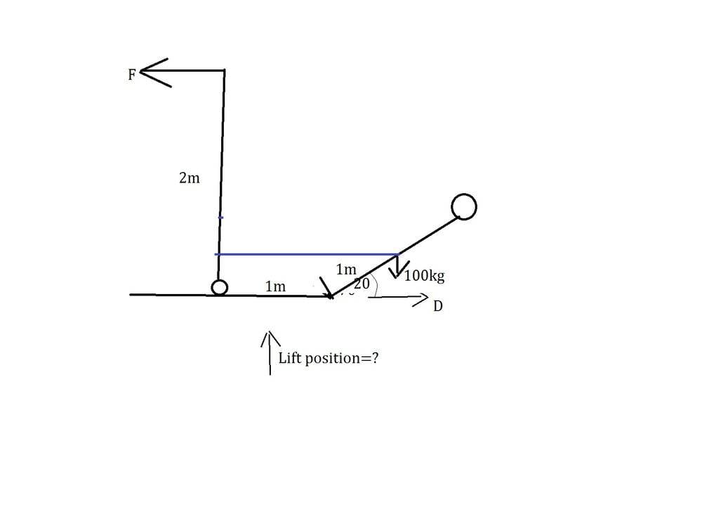

Find position and magnitude of lift force,system must be in balance..
first for sailor lean out angle 70 then for 20 degress
My results : lift position is for both case(70deg and 20 deg) below sailor feet and magnitude for both case is 1000N
mast force for 70deg case= 171N
mast force for 20deg case=469N
(I use 1kg=10N)70degress
20degress
View attachment 27914220degress
Edit; Sorry, I do see now that this is a complete answer. Ok, yes, I agree. Now what?

So these are figures for the 2-meter-high wind force that will be balanced by the surfer's tension on a horizontal line at 70 degrees and at 20 degrees. Yes, I agree. In both cases, the result is ##\frac{mgh \cos \theta}{H}##
We have the board+mast+sailor all balanced on a point support located at the sailor's feet. The farther back the sailor leans, the more clockwise torque from gravity about the support point. And the more counter-clockwise torque from wind that can be resisted.
In the toy model where the line is horizontal, it all boils down to a simple balance between sailor position and wind force.
russ_watters said:
You show me what answers you have calculated and how you calculated them.
In a bit more detail, do a torque balance on the sailor. Solve for tension. ##t = mg \cot \theta##. Multiply by sailor height above deck (##h \sin \theta##) and divide by mast height (H) to get force at top of mast. If you use g=10 m/s^2, h=1m, H=2m the numbers check out.
...I edited my reply above. It's enough of the answers for that step, to me. Now I'd like to know what his point is.

You ask me to prove math..here you are..
First, there is now need for any calculation for this easy case where line and mast force is horizontal,it is pure logic that lift force must be under sailor feet for both case for two reason.
1) line is horizontal so sailor don't "loose" any weight under his feet and don't produce any internal vertical force at joint
2)external mast force is horizontal so no any internal vertical force at joint
case 20degrees
1) find tension in rope T
calculate from moment at feet Mfeet=0
100kgxcos20 -Txcos70=0
T=274.4kg
2)calculate mast force
Mjoint=0
-Fx2m + 274.4kg x0.342m=0
F=46.9kg...469N
3)find Lift position and magnitude
magnitude is same as sailor weight...100kg=1000N clear as glass
Mjoint=0
-46,9kgx2m +100kgx1,9396m -100kg x X= 0
X=1m ...1meter right from joint is sailor feet..
double check with internal forces
Mjoint=0
100kgx1m -100kgx X=0
X=1m
(If line has some downard angle and mast force is horizontal,lift position will be somewhere left from sailor feet...that I can say just from logic,but in this case,I can't say accurate position without calculation..)

(If line has some downard angle and mast force is horizontal, lift position will be somewhere left from sailor feet...
I agree with that as well. So now what?
If evertyting is same just mast has fixed conection:
mast force will be
100kgx1,939m -Fx2m=0
F=96,98kg...969,8N
And lift magnitude will be 100kg..1000N and lift position will be under mast
Am I right?

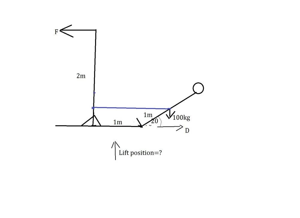

mast force will be
F=96,98kg...969,8N
Am I right?

russ_watters said:
Yes.
So you see that mast connection make difference.
So I can not look at first case with joint like it is rigid(welded mast)
What does it mean in practice,if I have fixed mast I can increase righting moment=increase sail power =go faster??
Sorry, no, I misread while multi-tasking. It was confusing when you said "everything is the same" and then started changing things.
If the only physical setup change is that you've added guy-wires to the mast, then nothing about the force balance changes.
But what is then wrong with my calculation,for joint case mast force is 469N and for fixed conection mast force is 969N.What did I wrong ?
John Mcrain said:
But what is then wrong with my calculation, for joint case mast force is 469N and for fixed conection mast force is 969N.What did I wrong ?
I think you assumed that the fixed mass applies a torque at the attachment point.
No, this does not make any sense.
You said that you 'keep everything the same', just fix the mast but you have NOT kept everything the same, you have changed the wind force on the mast.
In the diagram where the mast is 'not fixed', the lift point is only directly below the sailors feet because you have fixed it that way: you have assumed that there is no other torque on the board (for example due to buoyancy or tail fin drag) and so in order for it not to rotate the centre of lift has to act at the feet!
You have proved nothing about your 'model' of the side view of a windsurfer, but it is pointless discussing this model anyway, it is nothing like a real windsurfer which looks like this:

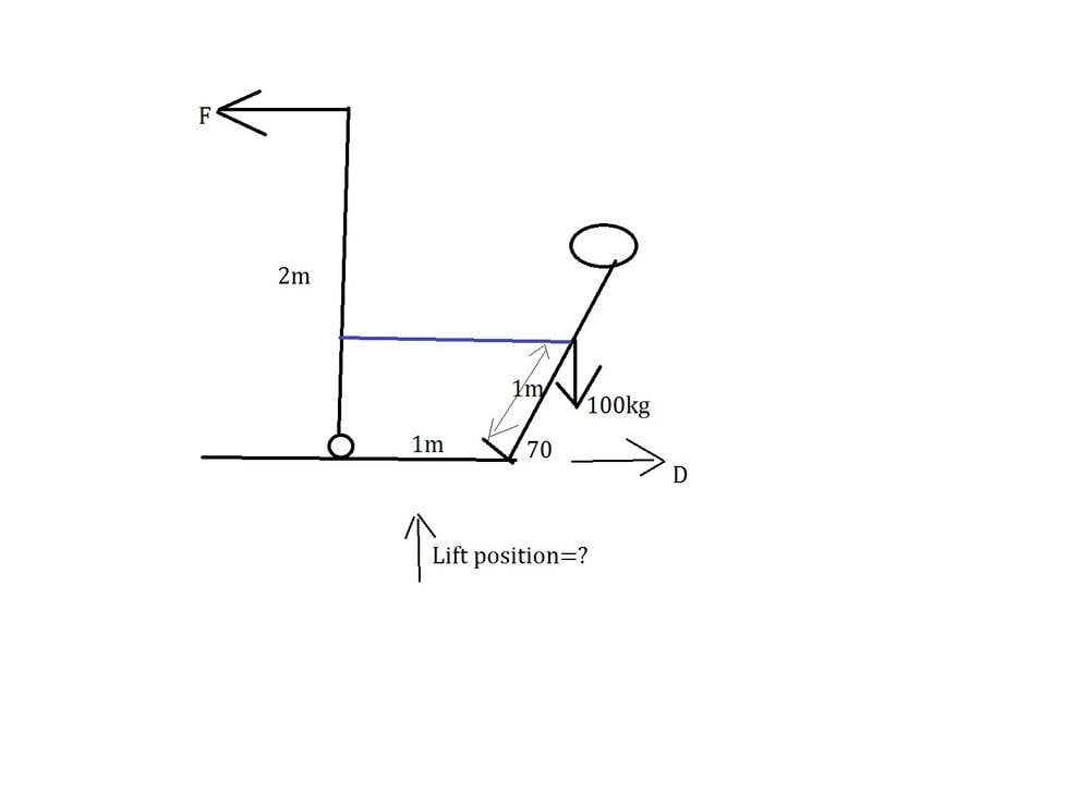

...also, I think I found an error here I didn't notice before. I only checked the 70 degree case, and my answer was 160 N. I figured there might be a rounding error difference, but maybe not: are you assuming the attachment point of the harness to the mast stays at 1m high? This may not matter to what you are really after though, so we can set it aside for now.
No ,you can see in my calculations, it is attached at sin20x1=0.342m (for 20degress case)
and sin70x1=0.939m for(70deg case..)
John Mcrain said:
I don't get it,what is your results for case at post #131?
If none of the forces change, then none of the forces change. But I'm not sure you had the right answer to begin with; I'm getting a different answer now (I only checked the first case and didn't realize it they weren't really in agreement because they were close).
With a 20 degree angle, the horizontal component of weight is 1000 cos(20) = 940 N.
The height of the attachment point of the harness is sin (20) = 0.342 m
The torque about the root of the mast is .342 * 940 = 321 N-m
The propulsion force is 321 / 2 = 161 N.
Yes, you've shortened the lever arm which provides the torque about the mast foot from the sailor and as a result you have had to reduce the wind force to keep everything in balance under the sailors feet.
I use sin20x1=0.342m for 20degress lean out angle
and sin70x1=0.939m for 70degrees case
What is wrong with this?
You must know that attachment point,and lean angle determine magnitude of mast force
Differnece between fixed connection and joint is almost double it is not rounding error..

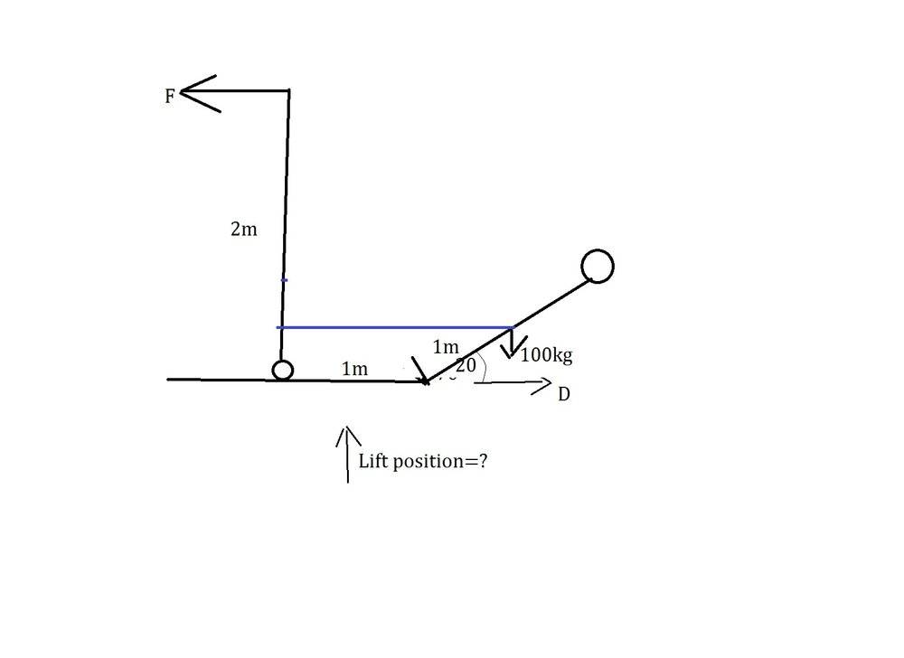

once again two cases
Task is find mast force,lift position and magnitude,for given geometry and weight at picture
20degress with joint
case 20degrees
T=274.4kg
Mjoint=0
F=46.9kg...460N
Mjoint=0
mast with joint,20degress
results:
Mast force= 460N
Lift position under sailor feet
fixed mast ,20 degrees
mast force will be
F=96,98kg...951N
fixed mast ,20degress
results:
mast force=951N
lift position under mast
What is wrong with this calculations??
A fixed connection doesn't on its own change anything. The forces and torques still have to balance. If the forces and torques are all balanced and the connection point has zero torque on it, then changing it to a fixed connection doesn't change the torque. Or to put it another way; since all joints are pins, none of them have torques around them. Changing them to fixed doesn't create a torque where none exists anyway.
Specifically:
[Case 1:]
T=274.4kg
F=46.9kg...460N
[Case 2:]
F=96,98kg...951N
For case 1, where does the 100 kg x 1.939m come from? And what happened to the tension on the harness (274.4*10=2744 N)?
[edit] Oh, I see it now; the 1.939 is the distance from the rider's COM to the mast. What does that have to do with anything? What do you think that is/is doing? It looks like you arbitrarily chose to increase the driving force and moved the center of lift to compensate. Why?
You mean on this part in case 1?
"Mjoint=0
X=1m ...1meter right from joint is sailor feet.."
Once when I calculate external mast force using internal geometry from picture,I am using external forces to find position of lift force.
Mjoint=0
Once when I calculate external mast force using internal geometry from picture,I am using external forces to find position of lift force.?
I see it now. So you've changed a lot more than just fixing the mast. Why did you move the lift force and increase the driving force? You didn't have to.
Are you kidding me or what?
I have given geometry and sailor weight at picture for these two caseses ,I must find/CALCULATE mast force,lift force position and magnitude..
So I didnt move lift force position and increase mast force by mayself deliberlty..
They end up like this when I calculate...Math did it...They are results,not something that I can choose..I can't believe what question you ask me!
