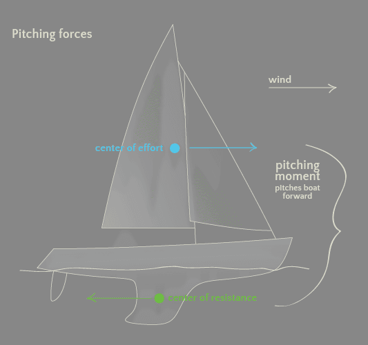

Sailing boat has pitching moment caused by sail drive force and hydrodnamic drag froce in the water,distance between them is lever arm.
It cause nose of boat to push down..
Does windsurfing has pitching moment and if yes how it is transfer to the board ,if sail is connected to board with universal joint and sailor feet also act as joint. But joint can not transfer moment..?
I don't understand physics of this..
Diagram of a sailboat labelled Pitching forces, showing wind arrow, centre of effort on the sail, centre of resistance below the hull, and a curved bracket marked pitching moment that pitches the boat forward.

The pitching moment you have shown for the boat is the external moment on the whole vessel. To analyse the moments on individual parts, you have to define precisely how you cut the system into parts.

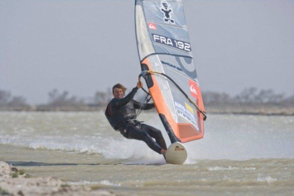

You can see at this picture,board nose is lift up,this ussusaly happened when you sheet out(reduced angle of attack of sail=reduced sail power).But once you again sheet in(increase sail power) nose of board will be pushed down,and board will be in control..
So my question is how sail power can push nose of board down,if sail is connect to board with universal joint and sailor stay at back of board in both footstraps all the time?

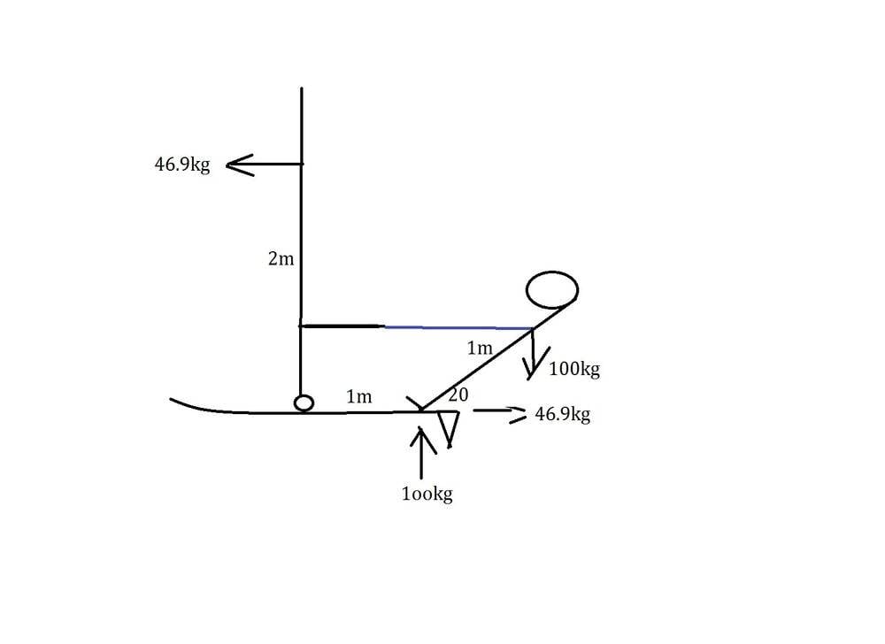

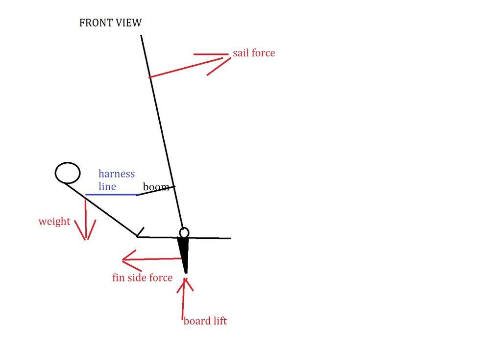

front view:
forget about arms, use only harness line that stay horizontal as picture show..

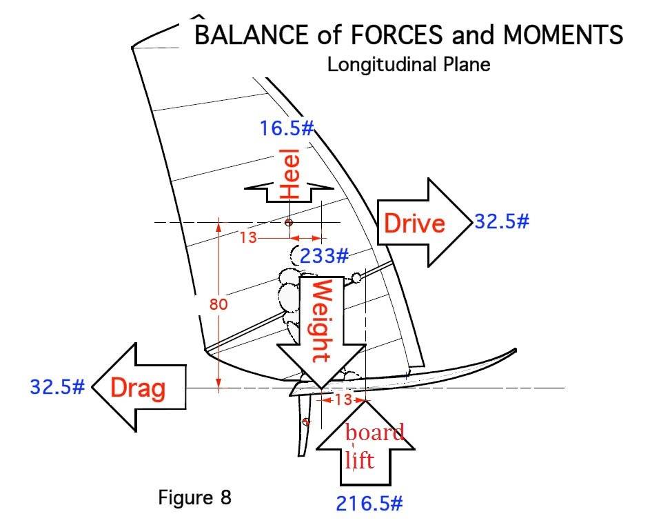

Figure 8, Balance of Forces and Moments, longitudinal plane: a sailboard with sail and rider showing Heel 16.5#, Drive 32.5#, Weight 233#, Drag 32.5#, board lift 216.5#, and dimensions 80 and 13.

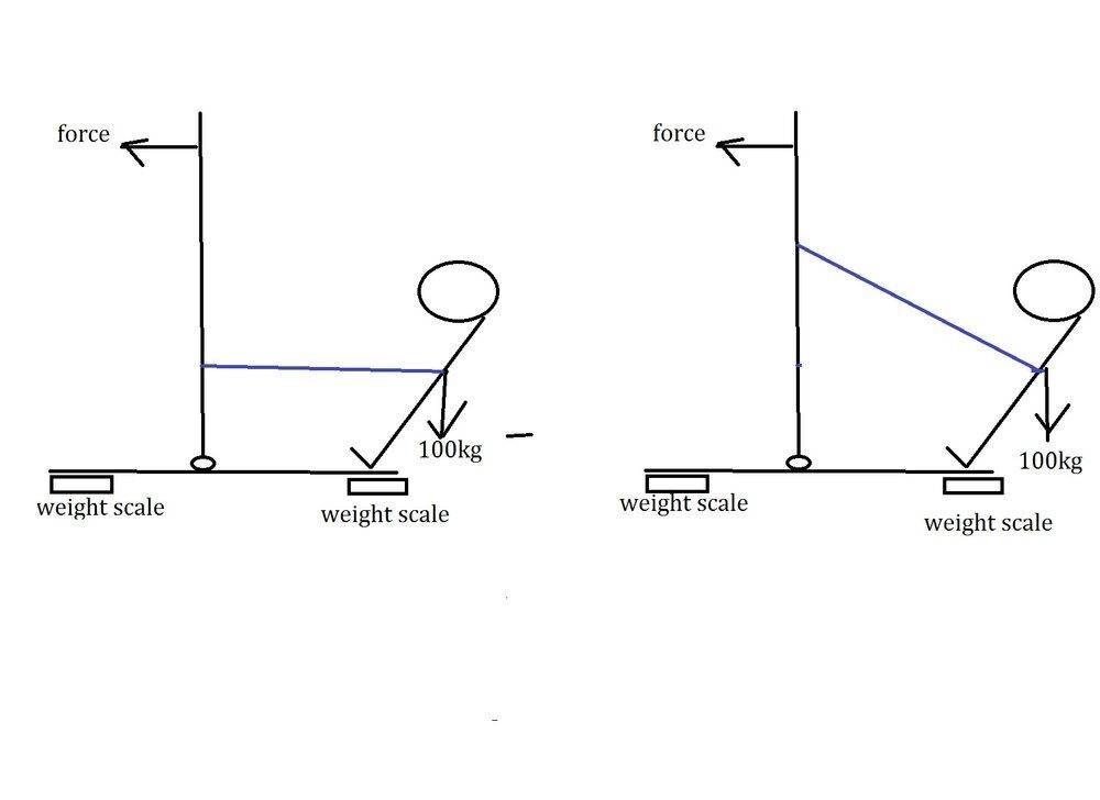

Questions :
1) Why this diagram treats wsurf as fixed connection,one rigid thing?
2)If drive force increase or center of effort in sail move up,will "board lift" force move to the right(towards nose)?If yes,what cause to put nose down if joints(feet and sail-joint) can't transfer moment to the board?(I use "board lift" position as indicator of what board nose is doing(we call this "board trim" or in sailing/aviation "pitching moment"),because board lift depend on wetted area,for example: if board lift is moved forward ,that mean wetted area increase so nose must be more down,"board is glued to the water" which increase control but reduce speed because of increased wetted area...etc)
You can simplify by looking only on forces acting on the hull. That diagram "balances of forces and motion" is missing some critical forces on the hull.
  1. The force of the mast via universal joint or fixed joint.
  2. The force of gravity on the weight of the board. That acts through the center of gravity of the board.
  3. Buoyancy. It depends on portion of the board below the surface, which depends on the board angle. I think that is what the diagram calls board lift. Buoyancy acts through the center of buoyancy which is not the same place as the center of gravity.
  4. If there is a significant bow wave, then there is an additional force lifting the forward end of the wetted surface. (probably not significant for a windsurfer).
  5. Don't forget that the weight of the person pressing down on the board varies as he pulls on the boom, and the location of that force varies as the person moves. If you are trying to calculate nose up/down you should probably model the left foot and right foot separately.

Perhaps this will help you think about this problem. Consider a windsurfer moving in equilibrium, all parameters unchanging. Now imagine that at any of these points (sailor hands, feet, U-joint) things are allowed to slip; i.e the sailor let's go or suddenly the board is very slippery. What moves, and in which direction? This may help with insight into the forces at play.

The first picture in post #15 looks like a front view.
If you're only talking about pitch, then fair enough. From the questions in that post:
1) Why this diagram treats wsurf as fixed connection, one rigid thing?
The moments around the center of lift or pivot/anchor sum to zero, so it doesn't move. That doesn't mean it couldn't if they didn't sum to zero. If you prove or stipulate that they don't move, then you don't need to solve for those forces to figure out what happens to the board.
For that matter, you also know if the whole thing is stable, the torques about the center of buoyancy/lift sum to zero as well.
2)If drive force increase or center of effort in sail move up, will "board lift" force move to the right(towards nose)?If yes,what cause to put nose down if joints(feet and sail-joint) can't transfer moment to the board?
It looks to me like if the drive force increases or the center of lift moves up, the rider has to lean back further, pitching the nose up/moving the center of lift back.

When rider sheet in(increase sail power),nose goes down and when sheet out nose lift up.
You can see this in video at 1:44,rider is planning in both footstraps which are at back of board,he open sail too much,we call it "sheet out" (decrease sail power) and you can see how nose lift up.
My question is why when rider sheet in, nose goes down,how can I explain physics behind this?

In the diagram (labeled fig 8) everything is balanced. If you want to examine what happens when something changes, mark up the diagram to describe what is happening. Be specific, because right now you are jumping around. You've now listed 3 separate changes that could be analyzed (larger drive force, larger sail/higher center of force and sheeting out). Pick one and analyze it!

He's sheeting out to slow down, while at the same time he appears to be leaning back to deliberately pitch up
Nose pitch up allways happen when you sheet out, this is consequnece of reduced "mast foot pressure" as wsurf comunity love to say..

You should draw it on the diagram. What happens to the geometry when you change the boom height?
Once of tons links about mast foot pressure:
http://www.guycribb.com/userfiles/documents/downforce.pdf
(author use harness lines / hands angle as indicator of mast foot prressure,so he state if harness lines/hand point downward,you transfer some of your weight to the mast foot pressing the board down)
But I have three counterqeustion for that theory
1)harness lines/hands angle is internal force,how they can affect pitch of system?
2)also you can put harness lines /hands 100% horizontal and still put nose down every time you sheet in,so what now press nose down??
3)when you put boom up ,harnesslines/hands have more downward angle so from this theory mast foot pressure increase and nose must go down,but this is not case,because when you put boom up nose start to fly as video,practice confirm
I can't figure out what happened with geometry when change boom height.
I guess from my logic that rider arms has fixed length and some tunning tips links, low boom make sail more upright(less rake ,less tilt to windward),high boom put sail more above you(more rake ,more tilt to windward)...
The problem here is that you have an active human with many joints as part of the system, so biomechanics is part of it. Any change of the vessels geometry affects the pose the human will take, and where his center of mass will end up.
