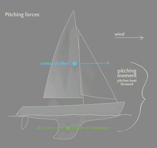

  • #168
John Mcrain said:
Sailing boat has pitching moment caused by sail drive force and hydrodnamic drag froce in the water,distance between them is lever arm.
It cause nose of boat to push down..
Does windsurfing has pitching moment and if yes how it is transfer to the board ,if sail is connected to board with universal joint and sailor feet also act as joint. But joint can not transfer moment..?
I don't understand physics of this..View attachment 278922
