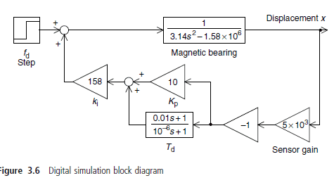

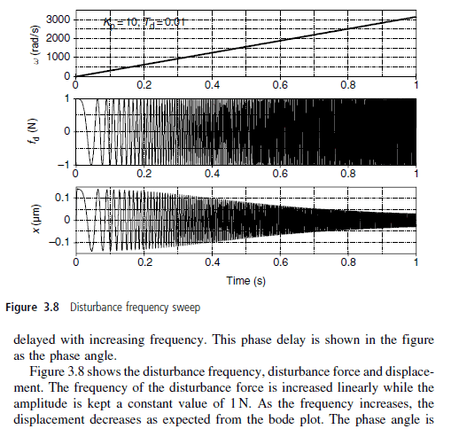

siddartha2 Messages 10 Reaction score 0 Thread starter Feb 15, 2010 #1 hi ! basically i need help in simulink plotting the output can anyone help i have attached the output desireed for my model in pic below below pleasez help me out guys thnx in advance Attachments model.PNG 6.2 KB · Views: 610 output.PNG 20.5 KB · Views: 594
