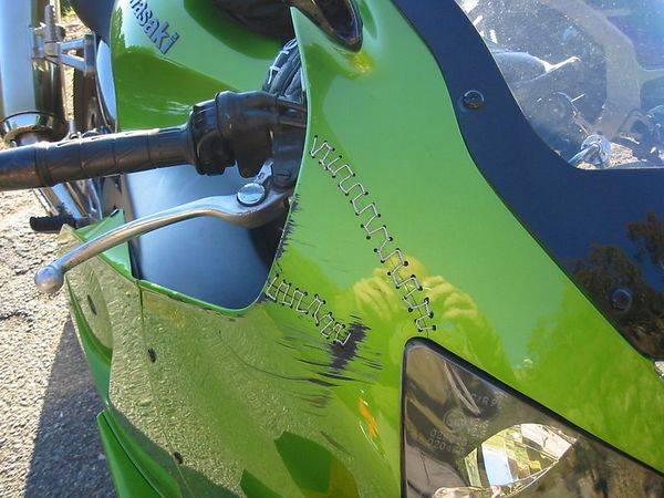

anyway one day I crash one of my race bikes and I broke the "Windscreen" among a few other things
so i did some "Face lifting"
some how i preffer to fix things and BE PrOuD of my adventures
i also done the same for others wunded bikes.

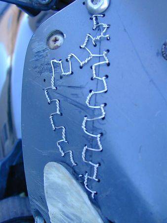

I ussually make holes at about 1/4' of a inch apart and about a 1/4' from the crack, i also try to make the holes on the other side aling so everything is simetrical.
this picture is from another bike but maybe will show how is done much better.
First thing is to cut a strand of wire about two feet long (much more than that is just a pain because it gets entangle to easy) of the thinnest you can find (sorry I don't remenber the gauge) I start by I inserting the wire from the "Back side" and then chose one of the holes (does not really matter what side) to start the spin, i ussually do five turns (by hand, no need for pliers) that is about the right amount of tension for a 1/4" distance, after i finish spining the two wires I procede to the next hole on the same side, I insert one of the two wires (I try to keep it even so i don't end up with one wire much longer than the other one) to go into the "back side" and the other one goes to the opossite side on the surface were i start the process again on the oposite side so i get this "zig-zag" look
another detail so you can see the height a little better, you want to keep the repair as close to the surface as posible so does not get entangle with stuff (not like is anything spyke or anything.)
this is the underside of the beak ( same as any other repair) you can see that is no strands of safety wire to cut your fingers and get "Velcro" to your gloves, cleaning rags and clothes) and in fact it looks like a fancy shoe lace work (you can also select to use this as the visible side) sometimes if the crack is to long i will use more than one piece of wire and i simply cover the extra "spyke" wire with more lacing.
this is a corner detail of the repair, maybe the most complicated part of the repair since you have two rathios changing in distance, oh well..

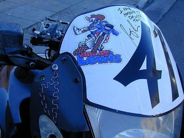

here is the beak fix and ready to be reinstall
repair and install on the bike and ready to be crash again hopefully by some Amazon woman so i can "Play Doctor" again.
