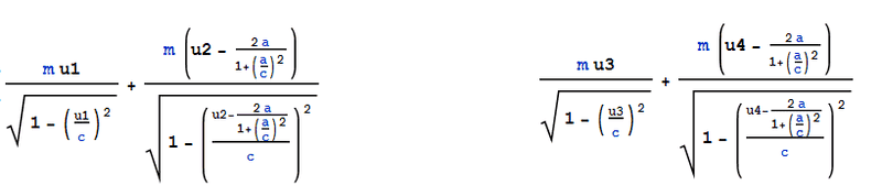

First, please, zoom in the attached file and take a look on it. Image 1 demonstrates the situation: two identical balls collide, horizontal component of velocity of both remains unchanged and vertical component becomes opposite as a result of the collision. Table in image 3 shows all the velocities in terms of a (horizontal component) and b (vertical).
Now we change the frame of reference into the one, which moves to the right on the speed of a. It is demonstrated on Image 2. New velocities are calculated via the relativistic velocity addition formula and are shown in the table on image 4.
Finally I calculated total momentum before (image 5) and total momentum after (image 6). Results are not equal! What did I do wrong?

Relativistic momentum is [itex]\vec{p}=\gamma(v)m \vec{v}[/itex]. You seem to be missing the "gammas" in your formulas.
No, I don`t. On images 5-6 y - is gamma with respect to a.
Other gammas (with respect to other things) are already expanded.
The velocities of the balls won't be the same in the new reference frame, so the betas are different for the different particles.
It would help to see how you derived those expressions for the momenta.

OK, try writing by components:
[tex]\gamma(v_A) \vec{v_A}+\gamma(v_B) \vec{v_B}=\gamma(v'_A) \vec{v'_A}+\gamma(v'_B) \vec{v'_B}[/tex]
It is difficult to decipher from your formulas.

Now, to calculate momentum used this one:
http://stg741.rusfolder.com/preview/20140518/2/40731162_3_1176207.jpg
Then a simple substitution of what was in the table instead of velocity there :)
And, of course, I summed up initial momenta of balls on image 5 and finals of image 6

what are you using for the γ and β in the expression for the velocities?

But you seem to be using the SAME [itex]\gamma[/itex] in all you formulas , this is not right. The " gammas" must be ALL DIFFERENT, see post 5. It is difficult to see what you are doing, I asked you two write the formulas component by component (first x, then y). Then we can see what is going wrong. Can you do it for x first?
x has no problems. It is conserved. I do not include it at all. Working only with y.
dauto, I`m not. Other gammas are expanded.

...but you seem to have the SAME "gamma" in all the terms (it is difficult to decipher your writeup, so I might be wrong).
It is also not clear what you have as equation as conservation, there is no equation to speak of, where is your:
Yes, I do, but it comes from relativistic velocity addition, as I wrote before. It must be the same, since we are in the same frame. Again, it is given in the book. Then I`m using the second formula (momentum one) and substitute data from the table, getting different gammas.

There are FIVE "gammas": [itex]\gamma(v_A),\gamma(v_B), \gamma(v'_A),\gamma(v'_B), \gamma(V)[/itex]

I found the mistake, it was difficult due to the presentation. Looking at image 5:
You calculate [itex]\gamma(v_A)[/itex] correctly but your [itex]\gamma(v_B)[/itex] is incorrect, you need to use [itex]v_B^2=(\frac{2a}{1+\beta^2})^2+(\frac{b}{\gamma(1+\beta^2})^2[/itex]
You have used only the y -component of [itex]v_B[/itex], you completely forgot to add the x component.

[itex]p= \gamma mu[/itex]
Total momenta before the collision:
[itex]\sum p_{before}=\gamma(u_{1}) mu_{1}+\gamma(u_{2}) mu_{2}=\frac{mu_{1}}{\sqrt{1-(\frac{u_{1}^2}{c^2})}}+\frac{mu_{2}}{\sqrt{1-(\frac{u_{2}^2}{c^2})}}[/itex]
That is how I got my equations. Then we just substitute the data from the table instead of u1 and u2 and do the same for total momenta after.
And then we find, that now the momentum is not conserved. That`s the problem!

This may be equivalent to what xox is saying, but you cannot use the co-linear velocity addition formula:
(u + v) / (1 + uv/c2)
for any non-colinear situation. Further, you cannot use it component wise in such a situation. There are several ways to state a more general velocity additions formula. My favorite is:
γ(relative) = γ(u)γ(v)(1-uv cos(θ))
then, from relative gamma you get relative speed.

And this is the problem. The velocity addition formula you use is wrong for this situation. It only applies to colinear velocities, and cannot be used component-wise.
Much simpler (for this problem), actually, is to arrive at values for S' by Lorentz transform. Then you don't need to worry about general velocity addition formulat - it is all contained in the Lorentz transform, from which all such auxiliary formulas are derived.
If there is a mistake it is either in the nature (less probable) or in the last step. Velocity addition is correct definitely :)

But you cannot break down the components that way. To get velocity of the 'top' ball in S' (for example), you must use the total formula with an angle neither 0 nor 90. It is not valid to break it up into colinear and orthogonal components.

I don't think you understand, you need the value [itex]v_B^2[/itex] in the calculation for [itex]\gamma(v_B)[/itex], you are incorrectly using only the y component. You make the same mistake in calculating [itex]\gamma(v'_B)[/itex]

For momenta, you can treat components separately. For relative velocities, you cannot. As to what is in the book, I don't have the book and thus it is more likely (to me) that you misinterpret what is stated in the book.
