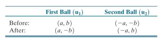

Please explain what is wrong with my relativistic momentum problem
The discussion revolves around a problem related to relativistic momentum in the context of a collision between two identical balls. Participants explore the calculations of momentum before and after the collision, particularly when changing frames of reference using the relativistic velocity addition formula. The scope includes theoretical reasoning and mathematical reasoning regarding momentum conservation.
  • One participant describes a scenario involving two balls colliding, with their velocities represented in terms of horizontal (a) and vertical (b) components.
  • Another participant suggests that the relativistic momentum formula, which includes the Lorentz factor (gamma), may not have been applied correctly in the calculations.
  • A different participant points out that the velocities of the balls will differ in the new reference frame, implying that the beta values (velocity as a fraction of the speed of light) are not the same for both particles.
  • One participant emphasizes the need to use conservation of momentum to find the final velocities and suggests that an error must have occurred if momentum is not conserved.
  • Another participant expresses that they are trying to verify momentum conservation based on experimental facts, indicating that their calculations show a discrepancy.
  • There is a discussion about the correct application of the gamma factors in the momentum calculations, with some participants suggesting that different gammas should be used for different components of velocity.
  • One participant acknowledges a mistake in their calculations regarding the gamma factor for one of the balls, indicating that they had not accounted for all components of velocity.

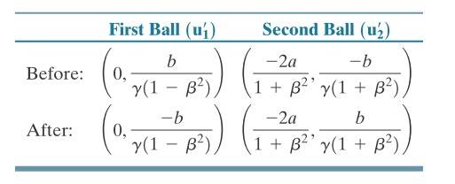

  • #31
I just copied the table as it is. It is not mine. And I don`t see any mistakes in it.
  • #32

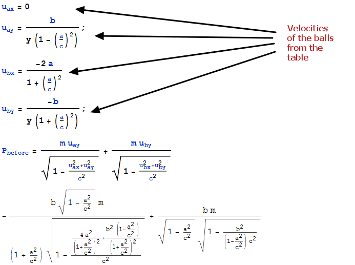

Virous said:
xox, please, write down the correct total momentum before and after equations, so I will understand it better :)
Before: [tex]\gamma(v_A) \vec{v_A}+\gamma(v_B) \vec{v_B}[/tex]
After: [tex]\gamma(v'_A) \vec{v'_A}+\gamma(v'_B) \vec{v'_B}[/tex]
You have everything correct, except the way you calculate [itex]\gamma(v_B), \gamma(v'_B)[/itex].
I explained the error.

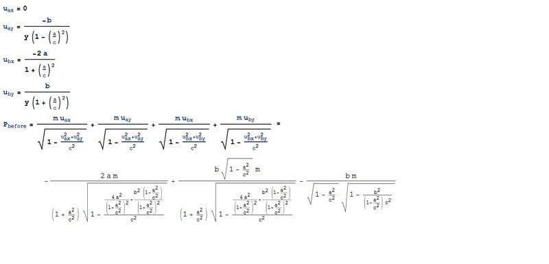

  • #34
PAllen said:
For momenta, you can treat components separately. For relative velocities, you cannot. As to what is in the book, I don't have the book and thus it is more likely (to me) that you misinterpret what is stated in the book.
He's projecting
[tex]\gamma(v_A) \vec{v_A}+\gamma(v_B) \vec{v_B}=\gamma(v'_A) \vec{v'_A}+\gamma(v'_B) \vec{v'_B}[/tex]
on the x and y axis, so his using of the components is correct. His error is in calculating the [itex]\gamma(v_B),\gamma(v'_B)[/itex]

  • #36
[itex]p=v_{b}m\gamma (v_{b})=\frac{v_{b}m}{\sqrt{1-(\frac{v_{b}^2}{c^2})}}[/itex]
This is my equation for initial momentum of the ball 2. (The one I used). With this equation the momentum is not conserved. Where exactly is the mistake?
xox said:
The masses cancel out because both particles have the same rest mass.
True, but you can`t cancel them out before equating total momentum before and after.

  • #38

  • #43
xox, Probably, I am getting annoying, so you`re using capitals. I am really-really sorry for that. I`m just getting into it. Please, write the equation of momentum of the ball B (2) substituting everything.
  • #44

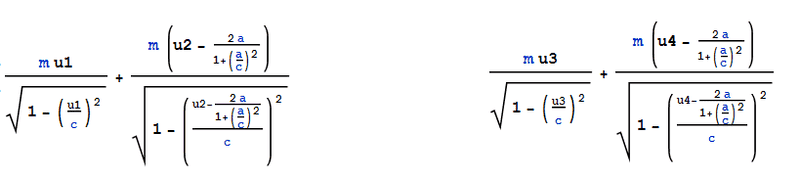

  • #48

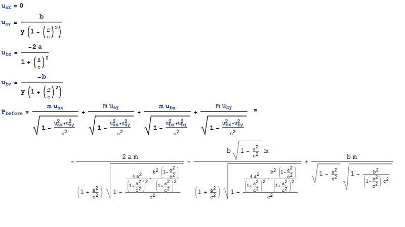

Probably I`m getting something absolutely wrong. Shouldn`t the following be the relativistic momentum formula?
[itex]p=\frac{mu}{\sqrt{1-(u/c)^2 }}[/itex]
Can you now, please, just take velocity values from my table and substitute them into the equation correctly?
  • #49
xox, I redid the computation as you told me - here is the result:
(Total momentum before on the left, total momentum after on the right)
u1, u2 - vertical components of balls` velocities before.
u3,u4 - vertical comoponents after
Sorry for not using special tegs. What I did is I added to u2 and u4 their horizontal components as they are given in the table.
Total before is still not equal to total after (they have opposite signs instead). What is wrong now?

  • #51
This is definitely not what I have told you.
In the unprimed frame, before the collision:
[tex]p_{Ax}=\frac{mu_{Ax}}{\sqrt{1-\frac{u_{Ax}^2+u_{Ay}^2}{c^2}}}[/tex]
[tex]p_{Ay}=\frac{mu_{Ay}}{\sqrt{1-\frac{u_{Ax}^2+u_{Ay}^2}{c^2}}}[/tex]
[tex]p_{Bx}=\frac{mu_{Bx}}{\sqrt{1-\frac{u_{Bx}^2+u_{By}^2}{c^2}}}[/tex]
[tex]p_{By}=\frac{mu_{By}}{\sqrt{1-\frac{u_{Bx}^2+u_{By}^2}{c^2}}}[/tex]
You calculate the above y incorrectly because you are inadvertently dropping [itex]u_{x}[/itex] in the calculation of your [itex]\gamma[/itex] for [itex]p_{Ay}, p_{By}[/itex].
In the unprimed frame, after the collision:
[tex]p'_{Ax}=\frac{mu'_{Ax}}{\sqrt{1-\frac{u_{Ax}^{'2}+u_{Ay}^{'2}}{c^2}}}[/tex]
[tex]p'_{Ay}=\frac{mu'_{Ay}}{\sqrt{1-\frac{u_{Ax}^{'2}+u_{Ay}^{'2}}{c^2}}}[/tex]
[tex]p'_{Bx}=\frac{mu'_{Bx}}{\sqrt{1-\frac{u_{Bx}^{'2}+u_{By}^{'2}}{c^2}}}[/tex]
[tex]p'_{By}=\frac{mu'_{By}}{\sqrt{1-\frac{u_{Bx}^{'2}+u_{By}^{'2}}{c^2}}}[/tex]
You calculate the above y components incorrectly because you are inadvertently dropping [itex]u'_{x}[/itex] in the calculation of your [itex]\gamma[/itex] for [itex]p'_{Ay}, p'_{By}[/itex]. You need to start to be able to figure out your mistakes on your own after so many explanations are given.
If you look at the calculations that Peter Donis did for you, using 4 vectors and you ignore the first component (in "t") you will notice the correct formulas. Hopefully, you will notice how his [itex]\gamma[/itex] differs from yours.
  • #52
If by 'your table', you mean image 4 in you original post, I either don't understand it or disagree with it. The understanding issue is I still don't see where you define gamma and beta as used in those formulas. Also, in terms of simple (a,b) as defined in image 3, the Y coordinate velocity of ball 1 in S' should simply be:
b/√(1-a2)
(it's X coordinate velocity is zero, by construction, consistent with your image 4).
(In case it's unclear, I am taking (a,b) from your image 3 as given in units of c=1).

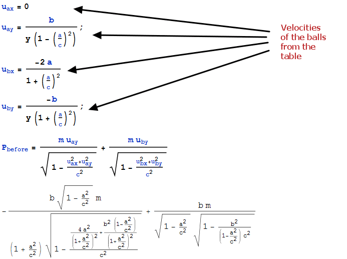

  • #53

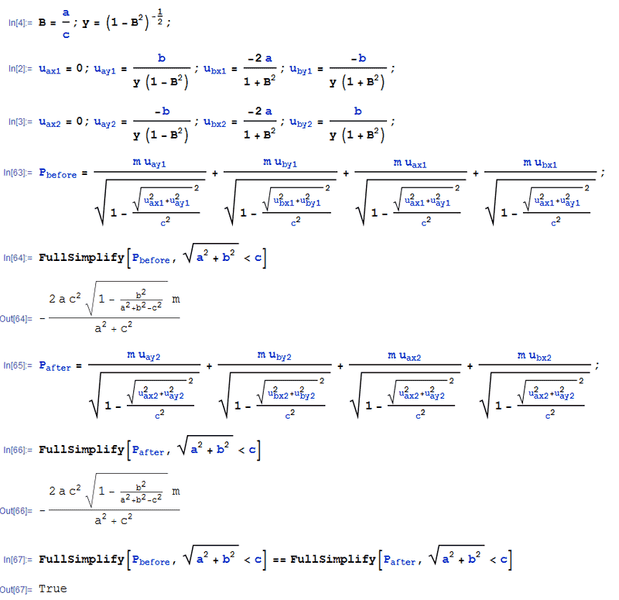

xox, that is exactly what I did. Your formulae:
Total momentum before:
Total after:
It is absolutely clear, that they are not equal!

  • #56
Total after:
Of course they are not, you are adding the x components with the y components, this is wrong. The conservation says:
[tex]p_{Ax}+p_{Bx}=p'_{Ax}+p'_{Bx}[/tex]
[tex]p_{Ay}+p_{By}=p'_{Ay}+p'_{By}[/tex]
Your [itex]p_{Before},p_{After}[/itex] are wrong since you are adding the x and y components.

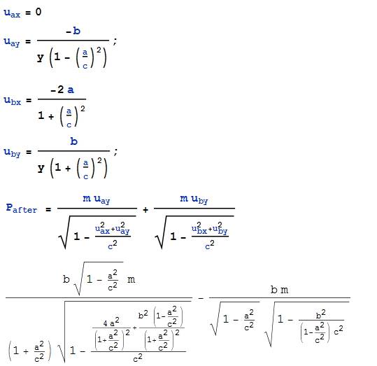

  • #57
xox, if a=b and c=d, than a+c=b+d isn`t it?
P.S. In the second image it should be Pafter. Sorry :)
