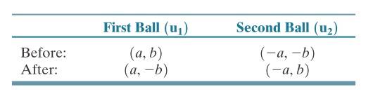

First, please, zoom in the attached file and take a look on it. Image 1 demonstrates the situation: two identical balls collide, horizontal component of velocity of both remains unchanged and vertical component becomes opposite as a result of the collision. Table in image 3 shows all the velocities in terms of a (horizontal component) and b (vertical).

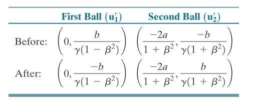

Now we change the frame of reference into the one, which moves to the right on the speed of a. It is demonstrated on Image 2. New velocities are calculated via the relativistic velocity addition formula and are shown in the table on image 4.

In the unprimed frame:
1. Before collision
[tex]\vec{u_A}=(a,b)[/tex]
[tex]\vec{u_B}=(-a,-b)[/tex]
2. After collision
[tex]\vec{u'_A}=(a,-b)[/tex]
[tex]\vec{u'_B}=(-a,b)[/tex]
Obviously the momentum before collision is equal to the momentum after collision:
[tex]p_{Ax}+p_{Bx}=p'_{Ax}+p'_{Bx}=0[/tex]
[tex]p_{Ay}+p_{By}=p'_{Ay}+p'_{By}=0[/tex]
If you get back to the very first post of mine, I have all the velocities in the primed frame in the table on Image 4. They are all calculated via relativistic addition formulae. Then, images I have in my previous post, just quoted by you are for primed frame. Unprimed frame is OK with me.
Yes, but we found out that your "gammas" were incorrect. Using the corrected "gammas", try writing the speeds and the equations of momentum conservation (as I did above) as measured from the boosted frame. Please do not mix the components, this makes error detection more difficult. BTW, I found another error, your Image 5,6 do not represent the "total momentum", you are missing one term in both "before" and "after". There should be 3 terms, not 2.

So, what we have initially is this:
This table shows the velocities of two balls before and after collision in terms of their vertical and horizontal components. That is how it happens in frams S.
Now we move to another frame S', which moves to the right with velocity of a. Recalculating of velocities gives:
This table was taken directly from the book (however, I checked it for errors several times and from my point of view it is fully correct). In this table gamma stands for [itex]\frac{1}{\sqrt{1-(\frac{a}{c})^2}}[/itex] and beta stands for a/c.

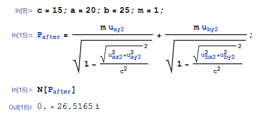

Now I tried to calculate momenta before and after. And what I did (by substitution to xox`s formulas) I have on these two images:
Before:
After:
It is clearly visible, that momenta are not conserved. I do not understand why.

Without x components of momenta:
  • #73
After:
  • #74

To derive these equations (in the table) I used velocity addition formula:
[itex]u'=\frac{u}{\gamma (1-\frac{u_{x}v}{c^2})}[/itex]
v here is a velocity of S' in S. It is a.
ux is -a, since Ball B moves to the left.
uy is -b.
If you`ll substitute, you`ll get the denominator with "+"

Actually, looking back at my post #37, I was wrong. The correct values for ##u_{ay}## and ##u_{by}## before (the only change in the after values is that the signs are swapped) are, as I noted in an earlier post, the ratios ##u^y / u^t## of the values from my post. Those are (again, I'm using units where ##c = 1##):
u_{ay} = \frac{b}{\sqrt{1 - a^2}}
u_{by} = \frac{- b \sqrt{1 - a^2}}{1 + a^2}
So the corresponding momentum values are (note that I'm using your values for ##u_{ax}## and ##u_{bx}##, which are correct):
p_{ay} = \frac{m u_{ay}}{\sqrt{1 - u_{ax}^2 - u_{ay}^2}} = \frac{m b}{\sqrt{1 - a^2} \sqrt{1 - b^2 / \left( 1 - a^2 \right)}} = \frac{m b}{\sqrt{1 - a^2 - b^2}}
p_{by} = \frac{m u_{by}}{\sqrt{1 - u_{bx}^2 - u_{by}^2}} = \frac{- m b \sqrt{1 - a^2}}{\left( 1 + a^2 \right) \sqrt{1 - \left( 2 a \right)^2 / \left( 1 + a^2 \right)^2 - b^2 \left( 1 - a^2 \right) / \left( 1 + a^2 \right)^2}} = \frac{- m b}{\sqrt{\left[ \left( 1 + a^2 \right)^2 - 4 a^2 \right] / \left( 1 - a^2 \right) - b^2}} = \frac{- m b}{\sqrt{1 - a^2 - b^2}}
So the ##y## momentum does cancel, as desired.

Oh, yeeeeees! I found it! It simplifies to zero. My problem was, that I fully relied on my Math software, and it for some reason didn`t simplified it completely, because of possiblity of imaginary roots in case of overcoming the speed of light!
Thanks to everyone! So, summarizing everything, my initial mistake was in the fact, that I had to add velocity components geometrically via pyphagora`s theorem!
