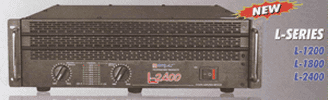

Hi to all much appreciation for you all,please is there anyone who can help me the schematic diagram of power amplifier ROYAL L1200

It looks like your question on allaboutcircuits.com isn't getting replies either. If you can't find it with a Google search (like I'm not able to find it), then most likely the schematic is proprietary. Why are you wanting a schematic? Do you need to fix one, or are you trying to reverse engineer it?

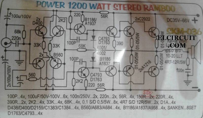

Fault finding does not usually need a schematic diagram.
Most amps are the same on the inside with only minor changes.
What power transistors are used, and how many per channel ?
Do you know when it was built, date codes ?
Can you produce a photo of the circuit board and the power supply.
What are the symptoms ?
There are several people on this forum who can tell you what to check next.
