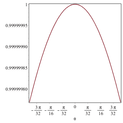

Plot the following function in maple (any graphics software):
[itex]I_\theta = I_m (cos (\beta))^2 \left( \frac{sin(\alpha)}{\alpha} \right)^2[/itex]
Range = -20 degrees to 20 degrees
[itex]\beta = \frac{\pi d}{\lambda} \sin(\theta)[/itex]
[itex]\alpha = \frac{\pi a}{\lambda} \sin(\theta)[/itex]
[itex]d = 0,2[/itex]
[itex]a = 0,1[/itex]
[itex]\lambda = 632,8[/itex]
This is the maple code:
plot((cos((Pi*.2)*sin(theta)/(632.8))^2)(sin((Pi*.1)*sin(theta)/(632.8))*(632.8)/((Pi*.1)*sin(theta)))^2, theta = convert(-20*degrees, radians) .. convert(20*degrees, radians), axes = boxed);
And in latex:
[itex]\displaystyle {\it plot} \left( \left( \left( \left( \cos \left( 0.0009929180323\\<br /> \mbox{}\,\sin \left( \theta \right) \right) \right) ^{2} \right) \left( 2014.264960\,{\frac {\sin \left( 0.0004964590161\\<br /> \mbox{}\,\sin \left( \theta \right) \right) }{\sin \left( \theta \right) }} \right) \right) ^{2},\theta={{\it convert} \left( -20\\<br /> \mbox{}\,{\it degrees},{\it radians} \right) \ldots {\it convert} \left( 20\,{\it degrees},{\it radians} \right) }\\<br /> \mbox{},{\it axes}={\it boxed} \right)[/itex]Yields this:
It should have a spike at (-17.5 degrees in radians) and at 0 degrees in radians and another at 17.5 degrees in radians. Mine has a single spike at 0 degrees in radians.

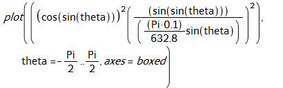

Your Maple code is wrong, I believe. Simplifying greatly, ##\cos(\beta) = \cos(\sin(\theta))## (with several factors removed), and similarly for ##\sin(\alpha)##. Your Maple code above appears to be multiplying these functions instead of using function composition.
Also, instead of working with the very long plot expression that you have above, it would be worthwhile to assign some variables above the plot statement. For example, create a variable and assign the value ##\pi/2## to it. And another for the 632.8 constant -- where does this one come from? Is that ##\frac{\pi \lambda}{d}##? It looks like you might have missed the other constant, ##\frac{\pi \lambda}{a}##.

I cleaned up the code, as you suggested
I can't see where the error is

With the parameters you gave, the intensity ##I_{\theta}## is smooth, has no "spikes" (if I understand that to mean a very sharp, pointed peak), and is so close to 1 for ##-20^o < \theta < 20^o## that it will plot as a straight line (unless you restrict the y-axis to values between about 0.999995 to 1.0, as you did in your first post).
You can see this easily. Let ##\beta = u \sin(\theta)## and ##\alpha = v \sin(\theta)##, where ##u = \pi d/ \lambda \doteq 0 .9929180323 \, 10^{-3}## and ##v = \pi a / \lambda \doteq 0.4964590161\, 10^{-3}##. Then, with ##\theta## in radians we have
[tex]I_{\theta} = \cos^2 (u \sin(\theta)) \, \left( \frac{\sin(v \sin(\theta))}{v \sin(\theta)} \right)^2[/tex]
Note that ##I_{\theta}## is an even function of ##\theta##, so to know its behavior on ##\theta \in (-\pi,\pi)## it is sufficient to restrict attention to the positive half ##\theta \in [0, \pi)##. You can find its local minimal on ##-\pi < \theta < \pi## by solving ##(d/d \, \theta) I_{\theta} = 0 ## numerically; the solution is at ##\theta = \theta_m = 1.5707963267948966192##, at which point we have ##I_{\theta} = .99999893185601793245##. In other words, on the interval ##-\pi < \theta < \pi## the function ##I_{\theta}## lies between a minimum of ##0.9999989## (at ##\theta = \pm 1.5707##) and a maximum of ##1.0## at ##\theta = 0##.
You can also see this using an expansion of ##I_{\theta}## around ##\theta = 0##. Its Maclaurin expansion is
[tex]I_{\theta} = 1 + p_2 S^2 + p_4 S^4+ p_6 S^6 + \cdots, \; \text{with } \; S = \sin(\theta)[/tex]
where
[tex]\begin{array}{lcr}<br /> p_2 &=&-0.10680434033590471660 \, 10^{-5} \\<br /> p_4& =&0.40768810279355082790 \, 10^{-12} \\<br /> p_6& =&-0.71916540449698892880 \, 10^{-19}<br /> \end{array}[/tex]
In other words, ##I_{\theta} \doteq 1 - 0.0000011 \, S^2 + 0.00000000000076 \, S^4 - 0.000000000000000000072 \, S^6 + \cdots##, for ##-1 < S = \sin(\theta) < 1##.
The results in your first post are correct, so your supposition about "spikes" is incorrect.

Include the units of the data.
The formula might be that of double-slit diffraction in terms of the deflection angle theta. 632.8 nm must be the wavelength of the incident light (from a He-Ne laser) 'a' is the slit width and 'b' is the distance between the slits. They are of micrometer size, comparable with the wavelength, cannot be 0.1 and 0.2 nm!
d = 0.2 mm = 200000 nm
a = 0.1 mm = 100000 nm
The plot still isn't right
Was not it a=0.01 mm and d=0.02 mm?
