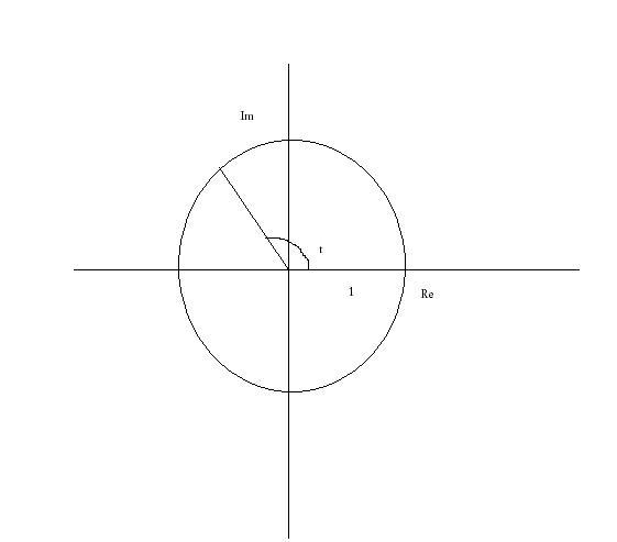

I thought of something Lanedance.
Since modulus for [tex]e^{it}[/tex] where [tex]0 \leq t \leq 2\pi[/tex] is one..
Then can't a plot of exp(it) as show in my file attachment. Don't know howto show something simular in Maple...
