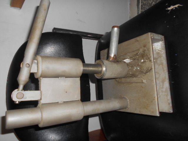

I need to build a pill crusher with very hard sell. I dont know how to calculate the Newton Needed so that i will be able to select the correct Pneumatic cylinder
This is my first post in this great community.
English is not my native language, so i am sorry for any mistakes.
I need to build a pill crusher using a pneumatic cylinder with 30mm stroke (effective travel).
i have e metal container with 25mm base diameter where i have to make powder from 6-8 pills.
this pills have very hard shell.
I have an other metal cup that fits as male plug on this container so manually i press this on container to crush the pills.
Even if i add all my wight on it, about 90kg, the pills do not crush so i have to twist the cup at the same time.
i need to make a press , but because this machine should be portable i have to select the smaller , more lightweight pneumatic cylinder.
I do have a manual press, so i will upload the geometrical shape and dimensions, of the press and what force did i apply to the press to achieve the effect.
More specific i will stand on a scale and will find out how much Newton were needed to achieve the result ("Total bodyweight - wight indicated on scale" and then convert kg to Newton).

Thank you for your reply.
I tried using the attached press with all my weight on the edge of the handle with not good result.
My fist thought was to use a pneumatic cylinder with 100mm bore and a 6bar pump. By this way i would get 480kg of force.

I have made some less than rigorous assumptions and have calculated the force of that impact.
Because it depends on magnitudes that are difficult to estimate correctly, the calculated value of that force is not to be trusted, but can give us an idea about the effective crushing force that you would need.
The press in your attached pictures seems to be able to deliver a force of 2650 Newtons on the male plug when you use your full weight (90 kg-force) at the end of the lever.
That is equivalent to a pressure of 5395 kPa or 53 atm between 25 mm diameter male plug and metal cup.

You have correctly calculated that your pneumatic cylinder, once extended the 30 mm stroke with no resistance and increasing internal pressure up to the claimed 6 bars, could be directly pushing the male plug over the pills with a force of 480 kg-force or 4710 N.
That force will be 1.8 times greater than the 2650 N that you could develop with the full weight of your body via that lever of mechanical advantage (MA) ≈ 3 (according to measurements of the picture of your hand press).
Nevertheless, we don’t know if that force will be enough for crushing up to 10 hard shell pills.
You could replicate that force in your hand press by extending the handle with a piece of pipe and applying the weight of your body at a point located from the fulcrum at 5.3 times the distance between fulcrum and link of the shaft of the male plug (previously anchoring the press to the table).
The only crushing-effective test you have done with that 200 grams weight could help us roughly estimate the needed force.
You manually hit the metallic container on a metal surface twice to create the powder.
Calculating the final force during the impact is very imprecise, due to gross assumptions we have to make about acceleration and speed.
Here are my attempts:
For a free fall of 200 grams from the used height of 40 to 50 cm:
##V_f=\sqrt{2gh}~=~\sqrt{(2)(9.81)(0.45)}~=~2.97 m/s##
##E_k=\frac 1 2 mV^2=(\frac 1 2)(0.2)(2.97)^2=0.88~ Joule##
##F_{avg}~d=E_k##
Assuming a crushing distance (d) of the pills of around 1 mm:
##F_{avg}=E_k/d=0.88/0.001=882~N##
Now, using the extra acceleration provided by your muscles, I loosely assume that you could achieve between double and triple the velocity of impact respect to free fall:
For 6 m/s:
##E_k=\frac 1 2 mV^2=(\frac 1 2)(0.2)(6)^2=3.6~ Joule##
##F_{avg}=E_k/d=3.6/0.001=3600~N##
For 9 m/s (measured maximum speed of boxing punch):
##E_k=\frac 1 2 mV^2=(\frac 1 2)(0.2)(9)^2=8.1~ Joule##
##F_{avg}=E_k/d=8.1/0.001=8100~N##
Since there was no combined rotation in your test, perhaps less axial force than estimated will be needed for the worse case of 10 hard shell pills.
Practical considerations:
1) Rotation will be less effective on pills that fall in place close to the axis of rotation, as tangencial velocity will be minimum around there.
Perhaps devising something to guide the pills to avoid that location could drastically reduce needed crushing force and time.
2) The thickness or height of your pills will vary.
Consider quick adjustable location of the beginning of axial force application (which the pneumatic cylinder, as well as the manual lever, automatically do).
For a solution of fixed or lockable stroke, I would recommend a flexible element under the metal cup, like a strong axial spring or chunk of hard rubber.
3) Consider that, in the hand press of your picture, when inducing rotation with one hand, the force on the lever may be unconsciously reduced.
In order to avoid creating a new pill by excess of compression, I like the idea of locking the mechanism that produces the axial force, once a maximum value is reached; then, using rotation (under constant axial pressure) for breaking the pill by shear effect.
4) The press of your picture is wasting too much trajectory of the end of the lever.
The crushing axial distance may be in the range of 1 mm; that little thickness or height of the pill is what really needs huge crushing force.
Consider a quick-release mechanism that allows the operator to effortlessly locate the male plug directly in contact with the surface of the pills prior the axial force is applied.
That way, you could achieve greater mechanical advantage with a manual press, using the same amount of trajectory of the hand on the lever.

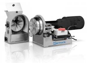

These are the people that invented the mechanized grinding of pils:
https://www.retsch.com/downloads/
Note that in this rotating machine, the pills fall by gavity into a path that narrows more and more between both discs.
