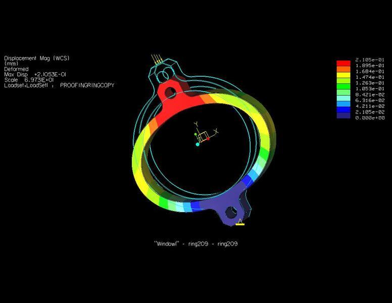

I need to find a suitable mathematical method of calculating the stresses at multiple points of a circular ring subjected to point loading. I'll calculate the rest myself- any suggestions?
You need to distinguish in-plane loading from out-of-plane loading. Do you mean normal stresses, shear stresses, or a combintaion?

Ok, thank you for replying. How do I go about that for a ring? I've only looked at beams before. I've been given some specifications as well as FEA analysis of normal (circumferential) stress, strain and displacement. The ring is being compressed between two plates and the force is applied in line with the centre. I need to validate the FEA results using some kind of mathematical method. I've been looking at Castigliano's method, but can only seem to evaluate the maximums. Is there a better approach that might be able to provide values at any given point?
This is one of the FEA results:
It's still not clear from your description 'force in line with the centre' whether the force is in the plane of the ring or perpendicular to it. If it is in the plane of the ring, does this mean there are just two point loads, diametrically opposite each other? Or are there other possible configurations of three or more point loads?
edit. sorry. just seen your figure. It's in-plane loading. I suggest you look at one of Timoshenko's books where arcate beams are treated well
As a rough check the combined normal stress formula N/A+-M/Z could be used on half the ring, splitting the load into two. So you get a semi-circle with encastre ends (i.e. moment-fixed). If the ends were not fixed, but pinned, the bending moment diagram would be the shape of the arc itself, with the base line being the straight between the points of application of the load. But, because the ends are fixed, the base line moves to reduce the bending moment at the outside, and to increase it on the line of action of the force. How much it moves I leave you to ponder...
