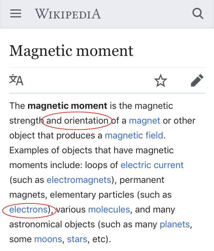

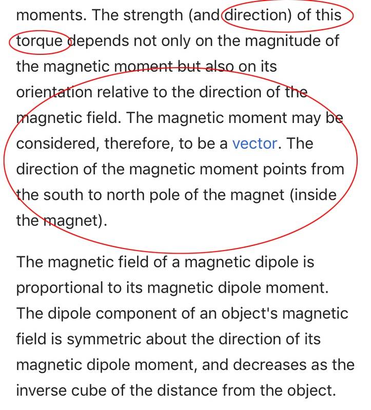

^I read that the electron has a magnetic moment, and the moment is considered a vector pointing from the south to the north pole of the magnet / electron.
