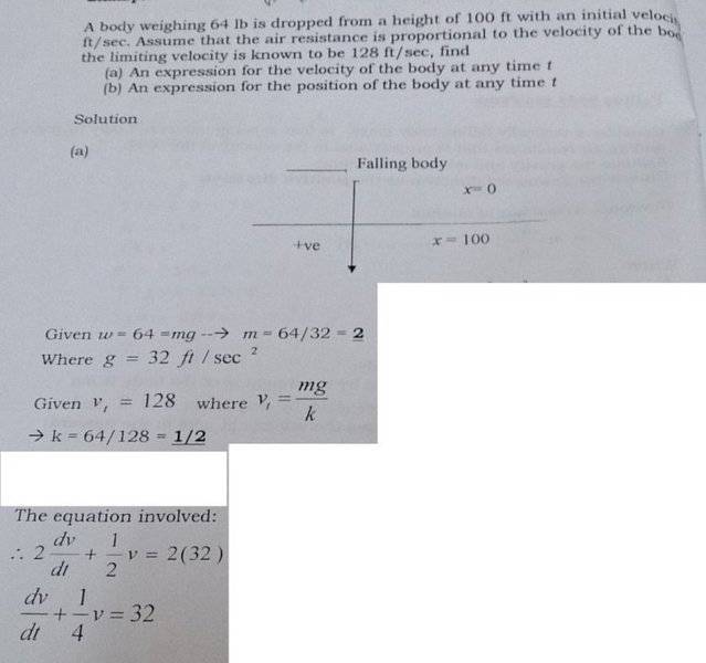

Position of Object Dropping from 100 ft: t=0, x=0?
4 replies · 1K views · last reply
foo9008
676
for part b , why when t = 0 , x= 0 , why not x =100 ? the author gave that the object drop from height of 100ft at the start of the question.
  • Handwritten-style solution sketch of a falling body problem: a downward-pointing +ve axis with x = 0 at the top and x = 100 at the bottom, then mass m = 64/32 = 2, k = 64/128 = 1/2, and the equation 2(dv/dt) + (1/2)v = 2(32), simplified to dv/dt + v/4 = 32.

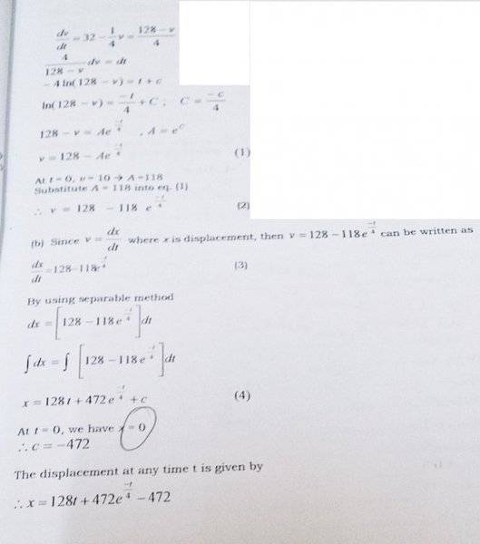

  • Handwritten derivation of a displacement equation by separation of variables, ending with x = 128t + 472e^(-t/4) - 472, with the condition x = 0 at t = 0 circled.
The author is defining the point at which the object is dropped as x = 0, and the point on the ground as x = 100.
Is it wrong to consider x=100 when t=0??
There are no "coordinates", x, y, t, etc. automatically given by a physical situation- you define those yourself. Here, where we have an object dropped from a height we can choose to take x to be 0 at the ground, in which case x(0)= 100, or we can choose to take the x to be 0 at the point from which the object was dropped so that x(0)= 0. We can also choose in which direction to take x to be positive or negative.
