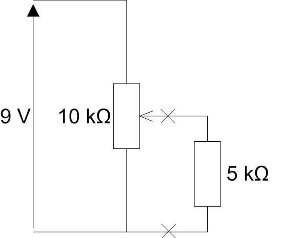

Thew circuit shows a 10KΩ potentiometer with a 5KΩ load. determine the position of the slider on the 'pot' when tthe voltage across points 'XX' is 3V
Vi=IR
I=V/R = 12/10x10^3 = 0.0012A = 1.2mA
Vo=IR
I=Vo/Io = 3/5x10^3 = 0.0006A = 0.6mA
Vi/Ri+Ro = 9/10x10^3 + 5x10^3 = 0.6mA
VD Across Ri =Vi =RiVi/Ri+Ro = RiVi/R

Let x = fraction of distance from ground to wiper.
Call the potentiometer resistance (10K) = R1 and the external resistor (5K) = R2.
Call 9V = Vi and wiper voltage = Vo = 3V.
Then redraw your circuit so that Vo/Vi consists of a voltage divider between two equivalent resistors.
What is the equivalent resistor going from Vi to Vo?
What is the equivalent resistor going from Vo to ground?
Solve for x.

The parallel resistance should depend on the position of the slider, and don't forget the third resistor in your analysis.
What do you mean with "put 3 V in the equation"? Just do it.

Your diagram is correct. But the parallel resistance is obviously a function of p.
yes, put 3V at the output and solve the whole thing for p.

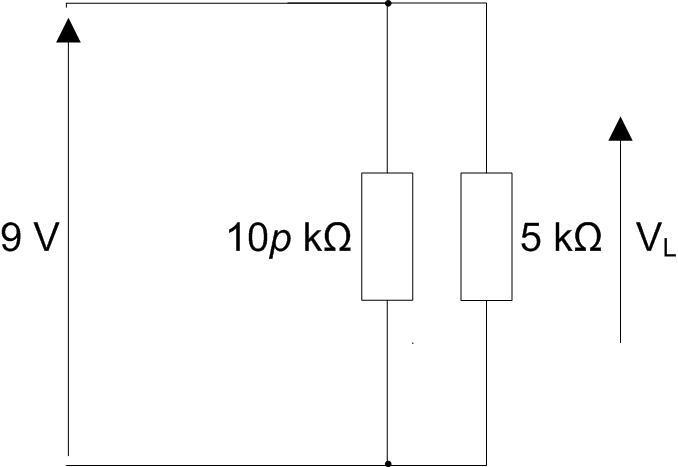

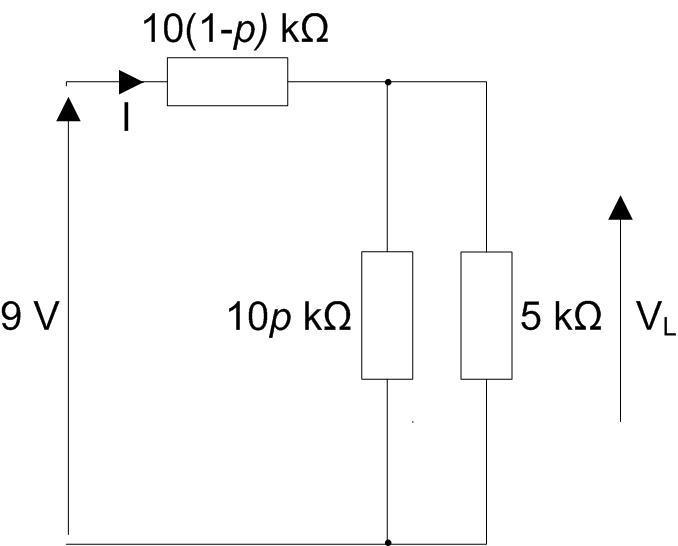

Let p represent the position of the ‘pot’ slider where 0≤p≤1 (i.e. the proportion of the ‘pot’ resistance that is in parallel with the load resistor). For p=0 the slider is at the bottom (minimum resistance) and for p=1 the slider is at the top (maximum resistance). The equivalent circuit is shown below.
The parallel resistance R_P is given by
R_P=(10p×5)/(10p+5) kΩ
=50p/(10p+5) kΩ

and the current I is given by
I=9/〖10(1-p)+R〗_P
=9/(10(1-p)+R_P ) mA
The voltage V_L across R_P is
V_L=I×R_P
=(9R_P)/(10(1-p)+R_P )
=(9×10p)/(10(1-p)(2p+1)+10p)
Now V_L=3 so
3=(9×10p)/(10(1-p)(2p+1)+10p)
3=9p/((1-p)(2p+1)+p)
(1-p)(2p+1)+p=3p
2p+1-2p^2-p+p=3p
0=2p^2+p-1
Therefore,
p=(-1±√(1-2(2)(-1) ))/(2×2)
=(-1±√9)/4
=(-1±3)/4
Since 0≤p≤1 then p=0.5. Thus the slider is at the midpoint position of the ‘pot’.
Check: R_P=2.5 kΩ which is in series with a resistance of 5 kΩ so the voltage V_L across the load is
V_L=(9×2.5)/(2.5+5)
=3 V
Looking good. I didn't check all your math but you have the right approach & the answer is of course correct also.
