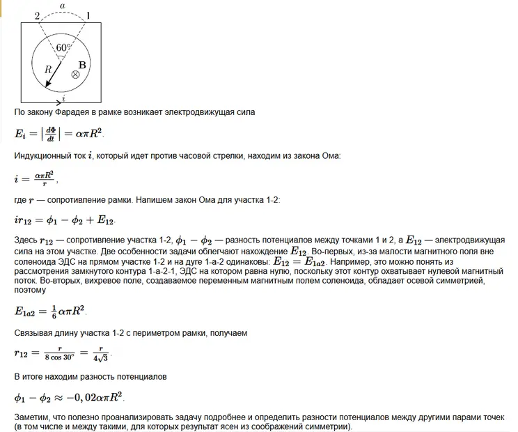

Here is the problem:
A conducting square loop symmetrically encloses a solenoid of radius ##R##. The magnetic field inside the solenoid is directed into the page and increases linearly with time as: ##B = \alpha t##
Neglecting the magnetic field outside the solenoid, find the potential difference between points 1 and 2, which are equidistant from the corners of the square (see figure).
$$\vec{E} = -\nabla V -\frac{\partial \vec{A}}{\partial t}$$
There will be a non-conservative electric field here, and I wonder if it is possible to have a conservative electric field and therefore a potential difference here?

Here is the solution, personally I think it is impossible to define electric potential in this case, because the electric field is not conservative.
I agree that the field is not conservative, but so what? Is there not an electric field at all points outside the solenoid that can be determined using Faraday's law? Is the potential difference (or the work per unit charge) not given by $$\Delta V=-\int_1^2\mathbf E \cdot d\mathbf l~?$$The analog in mechanics would be to calculate the work per unit mass done by friction when a box is dragged across a floor. It can be done even though the force of friction cannot be derived from a potential.

There will be some static charge distribution on the square loop when it is carrying current. The field of this charge “distorts” the induced electric field produced by the solenoid alone. Thus, some people like to think of the net electric field as a superposition of the field of the static charge and the induced field of the solenoid. $$\mathbf{E}_{\rm net}(\mathbf{r}) = \mathbf{E}_{\rm st \, ch}(\mathbf{r}) + \mathbf{E}_{\rm sol}(\mathbf{r}).$$
The field associated with the static charge is conservative. So you can define a potential function ##\phi## associated with this field and write $$\mathbf{E}_{\rm net}(\mathbf{r}) = -\nabla \phi(\mathbf{r}) + \mathbf{E}_{\rm sol}(\mathbf{r})$$
Integrating this along the wire from point 1 to point 2: $$\int_1^2 \mathbf{E}_{\rm net} \cdot \mathbf{dl} = \phi_1 - \phi_2 + \int_1^2 \mathbf{E}_{\rm sol} \cdot \mathbf{dl}.$$ The left side equals ##i r_{12}## where ##i## is the current and ##r_{12}## is the resistance of the wire segment 1-2. This is the equation in the solution written as ##ir_{12} = \phi_1 - \phi_2 + E_{12}##
Apparently, the “potential difference” asked for in this problem is the potential difference ##\phi_1 - \phi_2## associated with the static charge field.
I don’t think the potential difference ##\phi_1 - \phi_2## has much physical significance. What’s important is the net electric field, which is nonconservative. For example, if a quantity of charge ## q## flows in the wire from point 1 to point 2, the heat produced in this part of the circuit is ##q \int_1^2 \mathbf{E}_{\rm net}\cdot \mathbf{dl}##, where the integration is along the wire from 1 to 2. The heat does not equal the change in “electrostatic potential energy” ##q \Delta \phi##.
