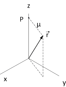

But I don't see the distance ##\mu## from a point ##\vec r## to ##\vec r'## of your volume element ##d\tau'## anywhere.
Make a sketch to convince yourself that ##\mu\ne|\vec r'|##

Well, then what is the relation between ##\mu## and ##r##?
It might go easier if you choose the axis orientation in such a way that P is on the ##z## axis ...

Well, this sketch really helpful to answer Vela's question. From this sketch, (also in general):
##\vec r## is position of the infinitesimal element from origin.
##\vec r'## is position of point of analysis (in this case is P)
##\vec \mu## is position of point of analysis wrt infinitesimal element.
Is that right?

Based on the BvU's figure, that's right. Griffiths, however, uses ##\vec r## for the position of P and ##\vec r'## for the position of the charge element, and he defines ##\vec \mu = \vec r - \vec r'##. In my copy of the book (2nd edition), Figure 2.3 illustrates this convention for discrete charges, but it's the same idea.

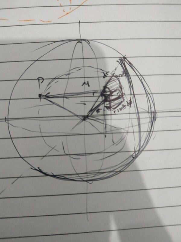

Can I assume that z is ##r' cos \theta##?
So far: (with Griffith Notation)
##\mu = \sqrt(z^2 +r'^2 - 2zr' cos \theta)##
$$dV = \frac {\rho}{4 \pi \epsilon_0} \frac{r'^2 sin \theta' dr' d\phi' d\theta'}{\sqrt{z^2 +r'^2 - 2zr' cos \theta}} $$
If now I assumme ##zz=r'cos\theta## then:
$$dV=\frac{\rho}{4 \pi \epsilon_0} \frac{r'^2 \sin \theta' dr' d\phi' d\theta'}{\sqrt{r'^2 \cos^2 \theta' +r'^2 - 2r'^2 \cos^2 \theta'}}$$
$$dV=\frac{\rho}{4 \pi \epsilon_0} \frac{r'^2 \sin \theta' dr' d\phi' d\theta'}{\sqrt{r'^2 - r'^2 \cos^2 \theta'}}$$
$$dV=\frac{\rho}{4 \pi \epsilon_0} \frac{r'^2 \sin \theta' dr' d\phi' d\theta'}{\sqrt{r'^2 \sin^2 \theta'}}$$
$$dV=\frac{\rho}{4 \pi \epsilon_0} \frac{r'^2 \sin \theta' dr' d\phi' d\theta'}{r'\sin \theta'}$$
$$dV=\frac{\rho}{4 \pi \epsilon_0} r' dr' d\phi' d\theta'$$
I think this is Wrong. ...

You mean ##r' \cos\theta'##, right? ##\theta## and ##\theta'## aren't interchangeable.
You don't need to assume anything. What do ##r' \cos\theta'## and ##z## represent? If they correspond to the same thing, you can set them equal to each other. If not, you can't.
##r' \cos\theta'## is the ##z##-coordinate of ##\vec r'##, the position of the infinitesimal element of charge. ##z## is the ##z##-coordinate of ##\vec r##, the point ##P## of interest. They're clearly not the same.
