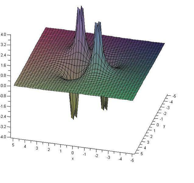

I think it is possible to make curves of zero potential in the plane. First let me take the case of 4 charges, 2 +ve, 2 -ve having the same magnitude. Now place them in a square formation with the center of the square lying at the origin of a 2-dimensional Cartesian system, with charges of same sign lying diagonally across. The potential along the x- and y-axes would be zero.
I've attached a 3dplot (generated in Maple) of the potential field generated by the configuration described above. For computational purposes, I placed the +1 charges at (-1,1) and (1,-1), and the -1 charges at (1,1) and (-1,-1). Keep in mind that the force generated by this potential is given by the gradient of the field. Clearly, this shows that the x and y axes are not lines along which the force vanishes. A simple check of this algebraically shows this to be true (pick any point on either axis and calculate the force there). The only (obvious) place that the force vanishes is at the origin...there may be others, but not infinitely many along a curve. This example shows that (in R^3) the z-axis is a line upon which the entire force vanishes, and is a specific case of the example I mentioned in my original post.

If the potential is actually a constant along a curve, then the electrostatic force is zero on that same curve (the force is the gradient of the potential: constant potential -> no slope -> zero gradient ->zero force). However, your example assumes that equipotential lines can exist in the plane. My questions is: is there a proof that equipotential lines can exist in the plane when all of the point charges generating the potential are in the plane?

2. Unfortunately, I did not pay much attention to the force along the curves with zero potential, although I did mention I was not convinced. It is obvious in the case of 4 charges that force is not zero along the x- and y- axes which have zero potential. Now let us examine your proof. It says : "If the potential is actually a constant along a curve, then the electrostatic force is zero on that same curve (the force is the gradient of the potential: constant potential -> no slope -> zero gradient ->zero force)." Consider the case of 2 equal and opposite charges : the line which bisects the line segment joining the 2 charges is an equipotential with V=0, it extends from -oo to +oo and yet the force along it is not zero, as it should have been using your logic
The problem lies with the interpretation of gradient as the change in potential along a curve. The rate of change in potential along a curve is given by the scalar product of the gradient and a unit tangent along the curve, and not by the gradient itself. This means that potential may be constant along a path (equipotentials) and yet the gradient of potential may not be zero (happens when gradient vector is always normal to the curve). Therefore although we can show the existence of curves of zero potential in a plane given n charges which can be arranged according to our liking, these curves (even if they extend from -oo to +oo) do not necessarily have zero field along them.
