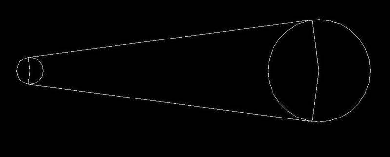

I need to know how much power it takes to accelerate a motorcycle chain weighing 1 pound in 1 second to a speed that would equal 20mph at the wheel from a dead stop.
The wheel has a diameter of 20 inches.
The drive sprocket has a diameter of 2.25 inches.
The driven sprocket has a diameter of 8.5 inches.
If for some reason we need the length of the chain, I suppose that would be 100 links at 5/8 inch per link.
Assume all frictions are zero and all sprockets and wheels are massless.
Here's where I tried:

Wait... Would the mass Mc be the mass ONLY of the part of the chain going straight? Seems like it would be... I think I screwed up. And likewise the mass of the chain traveling ONLY around the sprocket? And to complicate things, the chain doesn't wrap a full 180 degrees around the sprocket either... Do you think it matters much?
Like this:
You are correct. You only want to use the mass of the two sections that are going strait. Whether or not you assume the chains wrap 180 or not is up to and how accurate you want your calculations to be. Since your not considering friction I would just assume they wrap 180 degrees around the sprocket. That was the assumption I made in post #2

So, is it just that easy? Since the chain is connected we can treat it all as if it were going in a straight line? We don't need this moment of inertia stuff? Because I was starting to get some weird figures using those other equations:
Ig = (Mc*r1^2)/2 + (Mc*r2^2)/2
Pc = (Ig*alpha) x (alpha*t)
Ig = (.0235Kg * .0286m * .0286m) * 164/360 + (.1058Kg * .1080m * .1080m) * 196/360 = .00068063Kgmm
Pc = (.00068063Kgmm * 3.7998 m/s/s) * (3.7998 m/s/s * 1 second) = Huh?
f you consider the bike moving and ignore the turning of the chain, the energy added is 17.8 J. This is easy because the bike is moving at 20 mph.
(this is the calculation in my first reply)If you consider the chain turning, but the bike not moving, the energy added from rest is just 3.2 J. This is easy because every part of the chain is moving at 8.5 mph.
(my second reply)You can just add these to get the total energy which is 21 J which requires a power of 21 W for 1 second.
