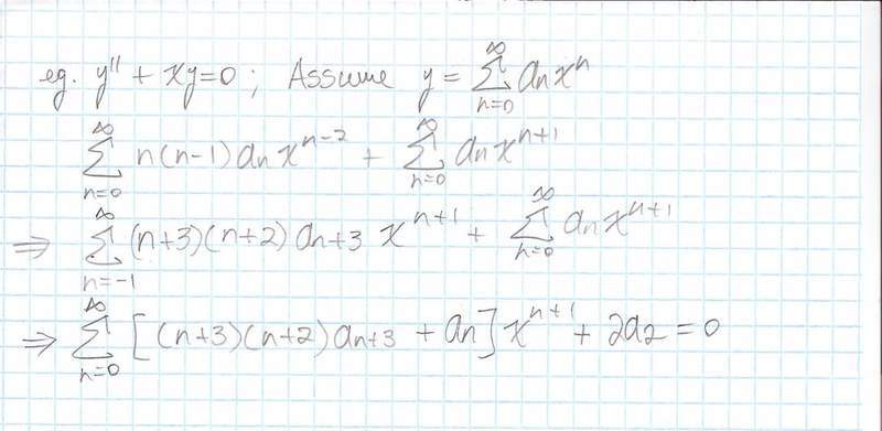

See figure attached, we are asked to use power series to solve the differential equation.
I'm confused as to how to deal with the -1 in the indices of one of my summations.
I could add the term on the outside and still simplify the two summations but how do I get past this point?
Can I just let a2 = 0?
Thanks again!

Looks okay so far. Every term in the series has to be equal to 0, from which it follows that a2=0, or, if you prefer, you can solve for a2 by letting x=0.
