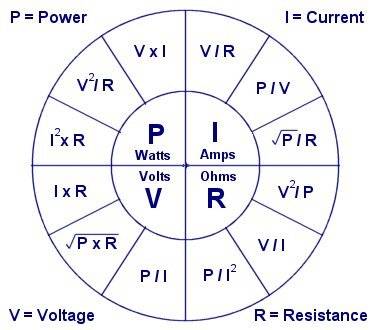

Ohm's law wheel diagram with P = Power, I = Current, V = Voltage, R = Resistance at the center; outer segments show formulas such as V x I, V/R, P/V, V^2/P, P/I, V/I, P/I^2, I x R, I^2 x R, V^2/R and sqrt(P) x R.
V squared / watts = R
to double check
R / 3v = 30.333ma
30.333ma * 3v = 91ohms
for laser power .030333amps(remember si units) * 3v = watts = 0.090999
now I feel stupid, I misplacing 0 or I'm not subtracting the 2 from 5 but I know from doing this many times that 30ma is the right current from experience. boy do I feel dumb:mad: something is wrong right now with my brain as it is missing placeholders so I did it on paper with the voltage drop and req current and got 66 ohms. no worrys it's only temporaryo_O but still this should be second nature to me.
btw, I got the whole town trying to steal and none knows or can do ohms law!:biggrin:
Wheel of fortune is way too complicated. Stick to V = I * R and P = V * I. All the others follow with simple math. :smile:
