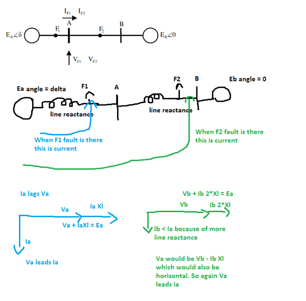

Handwritten sketch comparing two fault cases on a two-machine power system: a single-line diagram with lines F1 and F2, and phasor diagrams for the fault current lagging or leading the bus A voltage, with labels Ia, Va, Ia XI, Va + Ia XI = Ea and Vb + Ib 2XI = Ea.
In both cases the fault current lags the voltage at bus A.

Haste makes waste. I think your diagram is less than rigorous in assigning current directions.
Hand-drawn single-line diagram of a two-machine power system with a line reactance between each source and bus A and bus B, Ea angle = delta and Eb angle = 0, with blue and red annotations marking fault F1 and fault F2 and a green path showing the current direction.
But current is defined in problem statement as what flows at bus A which is in between the two fault locations.
Single-line circuit schematic with a source E_A at angle δ on the left, bus F1 and bus F2 along a line, bus A between them marked with a vertical bar, currents I_F1 and I_F2 drawn as arrows above the line and voltages V_F1 and V_F2 drawn below.
Will current there not flow toward the fault ?
If so,
In one case does it flow through A left to right , same way arrow is pointing, and in other case through A right to left, opposite the arrow ?
What would that do to its phasor?

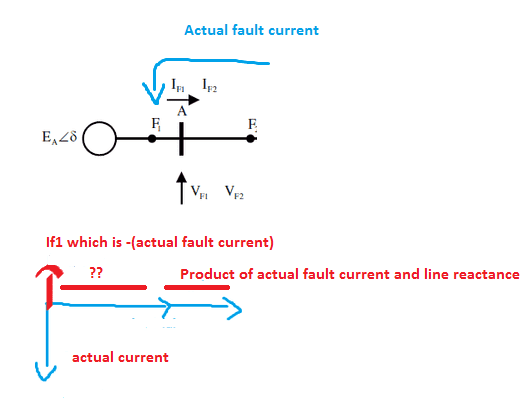

Hand-drawn sketch of a single-line power system: a source EA at angle δ connects through node F1 and a fault marker to node F2, with labels IF1, IF2, VF1 and VF2, an arrow for actual fault current, and a phasor-style note of If1 equal to negative actual fault current.
Is my above phasor right? What would the Ea be? Is that Va or Vf1?

Keep your thinking simple.
What is voltage at location of the fault ? Does EA matter at all ?
With no labels i don't know what it is that you drew.
Red text reading: If1 which is -(actual fault current)
Aha there's your next thought step.
What is the current flowing through A to reach the fault ?
Negating AC current shifts its phase 180 degrees, doesn't it ?
Think in simple steps. Write them out one per line.
That's probably the point of this homework problem.
Good luck in your studies. Remember, success is 1% inspiration 99% perspiration . So orderly disciplined thinking is your best ally.

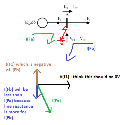

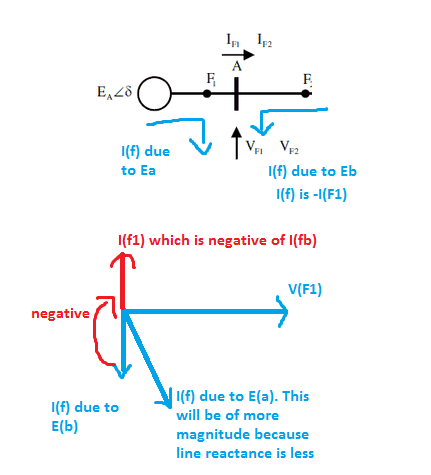

Thanks. Is this the right phasor?
Handwritten-annotated circuit schematic of a power line fault: source E_A angle delta feeds bus A, with line currents I_F1 and I_F2 and a fault to ground carrying I(Fa) and I(Fb), and voltages V_F1 and V_F2 marked, above a phasor diagram with I(F1), I(Fb) and I(Fa) arrows.
  • Top: single-line schematic of a source EA at angle δ feeding bus F1, then point A with fault current IF1 and IF2, then bus F2 with voltage VF1 and VF2 marked. Bottom: phasor diagram with V(F1) horizontal to the right, I(f1) pointing up in red labelled negative of I(fb), and I(f) due to E(a) and I(f) due to E(b) pointing down in blue.
  • Handwritten-annotated circuit schematic of a power line fault: source E_A angle delta feeds bus A, with line currents I_F1 and I_F2 and a fault to ground carrying I(Fa) and I(Fb), and voltages V_F1 and V_F2 marked, above a phasor diagram with I(F1), I(Fb) and I(Fa) arrows.
Annotated single-line power system diagram with source E_A at angle δ feeding bus A, currents I_F1 and I_F2, voltages V_F1 and V_F2, a fault branch to ground, and hand-drawn phasor sketches labelled I(Fa), I(Fb), I(F1) and V(f1).
Red line represents what ? I thought the fault was at F1 not at bus A.
I(FA) looks like a reasonable guess since we don't know the angle δ .so can't draw a phasor for VA.If V(f1) is zero why does your Black V(f1) phasor have nonzero length ? Are you saying it's the voltage at the fault, its lowercase "f" distinguishing it from voltage at bus A which has uppercase" F" VF1 ?
Were your fault at bus A then the voltage there would be zero. But there's some fraction of line impedance between Bus A and fault F1 .
Current through A is pushed toward the fault F1 by EB. Voltage at bus A, confusingly named VF1 instead of VBusA, is therefore nonzero.
It'll be some fraction of EB by voltage divider action. So we could draw a phasor for it . We could call it either VBusA, or VF1 .. It'll have same phase as EB just shorter length.
Were your black phasor labelled EB and VF1's phasor just a portion of EB 's i'd like your diagram a lot better.
Brown IF1 looks okay, i think you see that it has to be drawn up not down because of the current directions assigned.
That rigorous attention to detail is what it takes to get through EE. You'd best develop the self discipline now.
It's easy to do. What is difficult is to overcome our desire to leap straight to an answer instead of walking there one little step at a time..
That's mental laziness - recognize it as forbidden fruit .
This problem really boils down to basic circuit analysis. Be attentive to labels and assigned polarities and the algebra will work out.

Yeah i drew fault at wrong place. Red line should be at a bit left.
