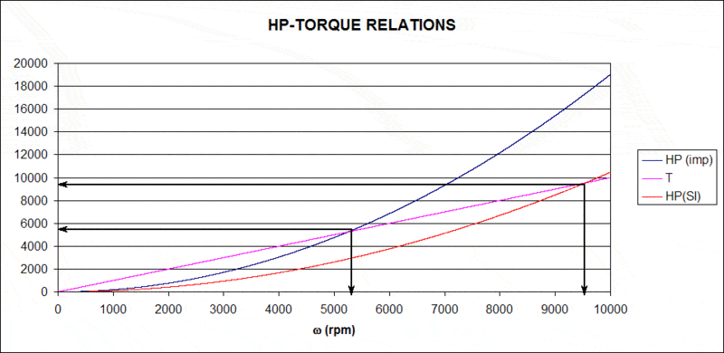

It works for me just fine
You use Excel for these quick plots?
Yup.
