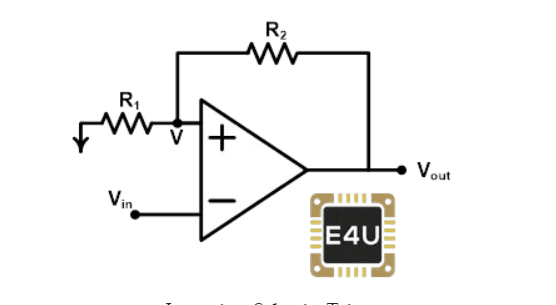

Design an inverting Schmitt Trigger using the following specifications -
a) Threshold Voltage : 2V
b) Noise band tolerance allowed : +- 0.3V
c) Dual Power Supply = +-8V
a) ##V_{out} = +-V_{sat}##
b) ##V_{threshold} = \frac{R1}{R1+R2} V_{out}##
This is regarding the positive feedback of an Op-Amp and the inverting Schmitt trigger. This is a typical inverting Schmitt trigger -
Circuit schematic of a non-inverting op-amp configuration with resistor R1 from ground to the non-inverting input labelled V, feedback resistor R2 from output to the non-inverting input, Vin on the inverting input, and output Vout.

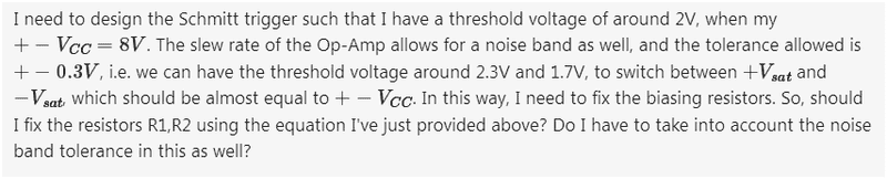

I need to design the Schmitt trigger such that I have a threshold voltage of around 2V, when my ##+-V_{CC} = 8V##. The slew rate of the Op-Amp allows for a noise band as well, and the tolerance allowed is ##+-0.3 V##, i.e. we can have the threshold voltage around 2.3V and 1.7V, to switch between ##+V_{sat}## and ##-V_{sat}##, which should be almost equal to ##+- V_{CC}##. In this way, I need to fix the biasing resistors. So, should I fix the resistors R1,R2 using the equation I've just provided above? Do I have to take into account the noise band tolerance in this as well?
I would not count on Vsat being almost equal to the rail voltages. I would include Vsat in the equations instead of the rail voltages.
So yeah, write the equations to generate 2.3V and 1.7V trip points using the positive feedback resistors. Are you required to use the circuit exactly as you showed it, or can you use a couple other resistors to help you generate the 2V centerpoint of the hysteresis trip points?

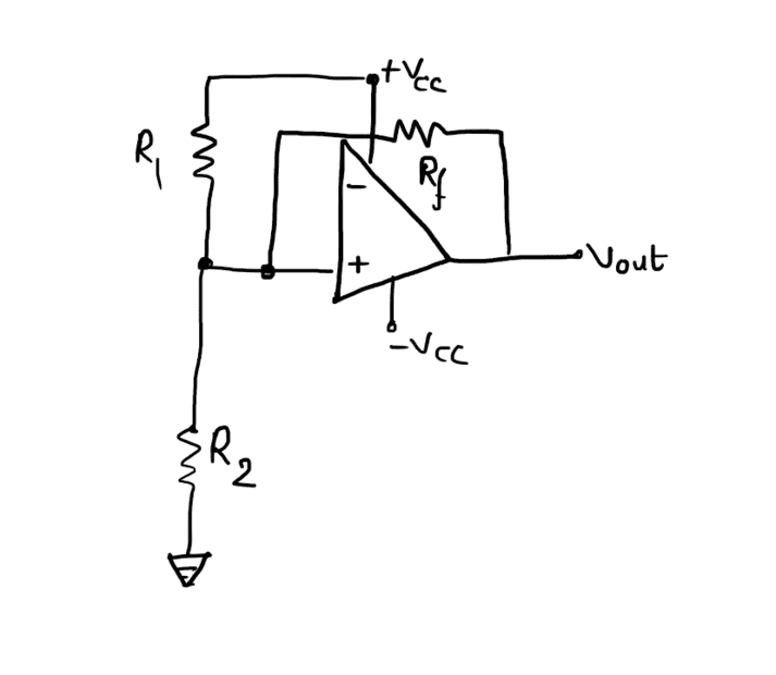

Here are the equations which I've finally come up with -
Let the voltage be ##+V_{CC}##. Now, writing the KCL equation, we have -
## \frac{V_{CC} - V_{+}}{R1} - \frac{V_{+}}{R2} - \frac{V_{out} - V_{+}}{Rf} = 0##
where R2 is the resistor to the ground, Rf is the feedback resistor, and R1 is connected to ##+V_{CC}##.
Finally, we get ##V_{+} = (\frac{1}{Rf+R1+R2})(\frac{V_{CC}}{R1} + \frac{V_{out}}{Rf}) ##
Now, the tripping voltages would be +2.3V and +1.7V. So, for the upper tripping point, ##+V_{sat}## is to be used, which is the high state, and for the lower point, ##-V_{sat}##, which is the low state. Am I correct in these? Can I move on to determine the resistor ratio from here, or do I need to deduce more?

Hand-drawn op-amp circuit: resistor R1 from +Vcc to the non-inverting input node, resistor R2 from that node to ground, feedback resistor Rf from the output back to the inverting input, output labelled Vout.
Something like this, I guess.

The last equation can't be correct, since the dimensions of the LHS and RHS don't match.
Yuo can write two equations, one for when Vout is high at +Vsat and one for when Vout is low at -Vsat. You can call R1 a known, and use the two equations to solve for the other two resistors.
I would also do it both for the configuration you show (with R2 to ground) and for the configuration that I originally suggest with R2's bottom end connected to the V- power rail. You may get better accuracy with one or the other configuration, but I'm not sure.

Can you tell me one thing though, how do I know that the reference is now set to 2V, and not 0V? How to determine this?
The voltage divider of R1 and R2 (and the voltages at each end of that 2-resistor string) determine the mid-point voltage at the + input to the opamp (with Rf not connected yet). Connecting Rf offsets the + input voltage higher or lower, depending on the value of Vout and the ratio of Rf to R1 and R2.
