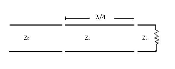

Hi guys. I have some questions about the practical use of a quarter wave transformer to match loads. For my question please refer to the figure below...
According to my reading the input inpedance fo a quarter wave transformer is:
Zin = Z12/ZL
and to properly match the line with characteristic impedance Z0 to the load ZL, Z1 must be chosen so that:
Z1 = √Z0ZL
So it seems that for the quarter wave transformer to be useful I wave to be able to choose a transmission line of the appropriate impedance Z1. When would that be of practical use? If i have only coax of 50Ω or75Ω etc., it seems I would have a difficult time finding an instance where I could use a quarter wave transformer. Obviously I'm missing something.
Diagram of a quarter-wave transformer: three transmission line sections drawn as parallel conductor pairs, labelled Z0, Z1 and ZL, with a lambda/4 span marked over the middle section and a zigzag resistor symbol for the load at the right end.
First, coax comes in many different impedances so you needn't stick to 50 or 75 ohms.
Second, quarter wave transformers are usually used with microstrip at UHF and microwave frequencies where it is easy to design a length of transmission line at nearly any impedance.
Third, you don't say if you are familiar with the Smith Chart but if you are, you can use it to match not just resistive values but also complex impedances with a just transmission line.
Fourth, if you can't find a coax of the appropriate impedance and if microstrip isn't appropriate, you can create a network that works the same as a quarter wave transformer with discrete components. You would use either a PI or T network made of two capacitors and one inductor or vice versa in which each component has a reactance equal to the value of the transmission line you would need.
Example: If you are trying to match 50 ohms to 100 ohms and you need a 71 ohm transmission line, you could use anyone of 2 PI or 2 T networks of L-C-L or C-L-C where each L and each C has a reactance of 71 ohms.

Like Skeptic 2 said, using microstrip or stripline to realize the λ/4 line of Z1 is the easiest as you can design the impedance to Z1 easily as long as it is within reason. Or used discrete components in Pi network will work. If you are familiar with matching network design using Smith Chart, it would be very easy to find the value of the components.
