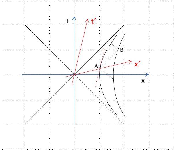

cianfa72 said:
ok, let's go back to the analysis in SR of the two accelerated spaceships with the same proper acceleration (i.e. accelerometers at rest in each of them measure the same constant proper acceleration). Just to take it simple we neglect their lenghts.
From the point of view of an SR inertial frame they undergo a motion with the same coordinate acceleration. Since the transformations from the inertial frame to end up in each of the two accelerated frames (coordinate systems) - in which each spaceship is at rest respectively - are the same then using the same argument as in post #51 we can conclude that physics laws have to be the same in both spaceships (i.e. same set of equations).
What about this claim, does it sound right ?
Thanks.

An accelerating frame is not in rest with reference even to itself. So how can we compare forces or relativistic effects between two co-moving but accelerating frames.
There's a problem with things like "same acceleration profile" and "same relative velocity" and "rigid acceleration". They are not mutually consistent. The front an back of a ship that accelerates, change relative velocity because time dilation is different at the front and back. "Rigid acceleration" is ill defined...nothing is rigid in relativity.
To say physics is the same in all inertial reference frames is right. To say it's the same in all reference frames is true too, except the reference frame has to be small enough that there is no significant difference in acceleration within the reference frame...it can't be extended to a global reference frame.

PeterDonis said:
It is perfectly possible to have an accelerating frame in which all objects with constant spatial coordinates are at rest relative to each other. The canonical example is Rindler coordinates in Minkowski spacetime.
At rest relative each other: is actually involved a physical procedure that each of them (i.e. let me say each of those objects) has to use to check it is actually at rest w.r.t. each of the others ? Thanks.
yes, constant round trip signal times.
