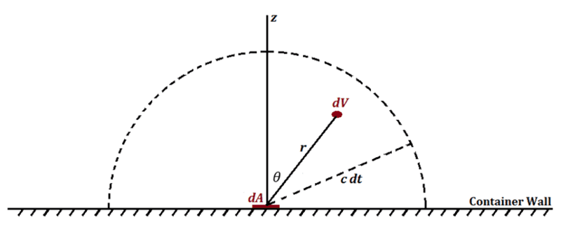

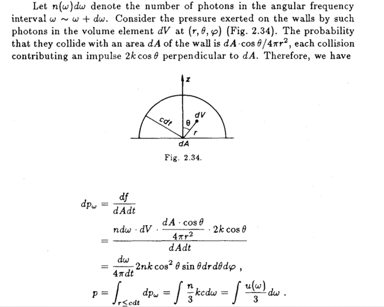

I was asked to derive the relation $$p = u/3$$ for photon gas. Now, i have used classical mechanics and symmetry considerations, but the book has solved it in a interisting way:
I can follow the whole solution given, the only problem is the one about the probability to colide the sphere!. Where does the ##cos(\theta)##, in ##dA cos(\theta)/(4 \pi r^2)## comes from? Why the top part of the sphere is benefited?
The derivation considers photons reflecting off a small element of area ##dA## of the container wall during a small interval of time ##dt##. For convenience, let ##t = 0## be the instant of time at the beginning of the interval ##dt##. At ##t = 0## there is a certain number of photons within the container and some of these will strike ##dA## during the interval ##dt##.
If a photon arrives at ##dA## at some instant within the interval ##dt##, we can think of the photon as having been within some volume element ##dV## at the instant ##t = 0##. In the figure, ##dV## represents one such volume element. It is evident that ##dV## must lie within a distance ##cdt## of ##dA## if any of its photons at ##t = 0## are to arrive at ##dA## during ##dt##. The number of photons with frequencies between ##\omega## and ##\omega + d\omega## that are contained in ##dV## (at any instant of time, and particularly at ##t = 0##) is ##n(\omega) d\omega dV##. Only a certain fraction of these photons in ##dV## at ##t = 0## will be moving in a direction that will lead them to ##dA##. Since we can assume an isotropic distribution of velocity directions of the photons, this fraction is the ratio of ##dA \cos \theta## to the total area of a sphere of radius ##r##. Note that ##dA \cos \theta## is the projection of ##dA## perpendicular to ##r##.
So, the number of photons that were in ##dV## at ##t = 0## that will strike ##dA## during ##dt## is $$n(\omega) d\omega dV \frac{ dA\cos\theta}{4 \pi r^2}$$
TSny said:
The derivation considers photons reflecting off a small element of area dA of the container wall
Ah! I had not realized that line was a wall. I thought that we were looking at a hemispheric projection from the side of a container.
