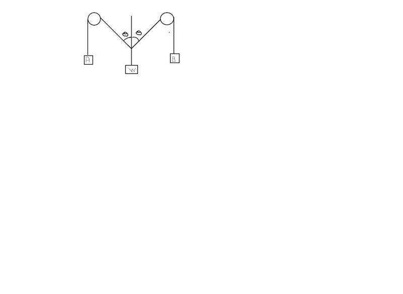

In the given figure if the masses A and B move down with a velocity 'v' at any moment then what will be the velocity with which mass W rises.
A purely logical answer would be appreciated and please don't use calculus based approach, as I don't know calculus. Also please see my attempt at the solution and correct me.
Trigonometric ratios
If the masses are moving downwards with a velocity 'v' then the string is also moving with the same velocity that is 'v' so the velocity with which the mass W should rise should be equal to
'v cos θ' but the correct answer is 'v/cos θ'. Please do tell me why my approach is wrong and what is the correct method

Quite so, but that means for W to stay connected to each string it must also have a velocity component v towards each pulley. If its speed is u then u cos θ = v.

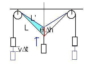

Let be the pieces of string between the pulleys and the middle weight of length L initially. A and B go downward by vΔt in a short time Δt. Then the pieces of the string between the pulley and the middle block get shorter, the new lengths are L'=L-vΔt. The weight raises by Δh.
Apply the Law of Cosine for the blue triangle : L'2=L2+(Δh)2-2LΔh cos(θ), and substitute L'=L-vΔt. Expand, simplify. vΔt and Δh are small, you can ignore their square.Isolate Δh. The speed of the middle block is Δh/Δt.
Could you please elaborate I think I'm getting it.
Correct me if I am wrong but I think that the conservation of momentum applies here. The momentum of A and B is must be equal and opposite to the momentum of W.
No, you don't need "conservation of momentum" or any reference to a force. You are told that "the masses are moving downwards with a velocity 'v'" so it is simply a matter of geometry- how does the contraction of the lengths of the sides of the triangle affect the height of the object.

In echild's figure in response 5, the three sides of the right triangle to the right are h(t)=Lcosθ, Lsinθ, and L. After a time interval Δt, the lengths of the three sides of the triangle become h(t+Δt), Lsinθ, and L-vΔt. These three sides of the right triangle have to satisfy the Pythagorean theorem, so:
[tex]h(t+Δt)=\sqrt{(L-vΔt)^2-(L\sinθ)^2}=\sqrt{L^2\cos^2θ-2vΔtL+v^2(Δt)^2}=\sqrt{h(t)^2-2v(h(t)/cosθ)Δt+v^2(Δt)^2}[/tex]
The average upward velocity of the center weight during the time interval Δt is given by:
[tex]w_{ave}=\frac{h(t)-h(t+Δt)}{Δt}=\frac{h(t)-\sqrt{h(t)^2-2v(h(t)/cosθ)Δt+v^2(Δt)^2}}{Δt}[/tex]
If we multiply numerator and denominator of this equation by [itex]h(t)+\sqrt{h(t)^2-2v(h(t)/cosθ)Δt+v^2(Δt)^2}[/itex], we obtain:
[tex]w_{ave}=\frac{2v(h(t)/cosθ)+v^2(Δt)}{h(t)+\sqrt{h(t)^2-2v(h(t)/cosθ)Δt+v^2(Δt)^2}}[/tex]
If we take the limit of this equation as the time interval Δt becomes small, we obtain the instantaneous velocity w:
[tex]w=\frac{v}{cosθ}[/tex]
Nice explanation! I applied the Law of Cosines for the blue triangle in my drawing, but it is the same in principle.
L'2=L2+(Δh)2-2L(Δh)cos(θ)
L'=L-(vΔt), plugging in, expanding, simplifying, ignoring squares of vΔt and Δh, you get the vertical velocity of the weight as u= Δh/Δt.ehild

The section of string on the weight's side of the pulley does not move upwards at speed v; it moves towards the pulley at speed v. The end connected to the weight must also be moving towards the pulley at speed v (or the string would change length), as well as moving tangentially, so as to produce a net vertical motion. I.e. the component of its vertical motion that is towards the pulley must be v. Therefore its vertical speed is v sec theta.

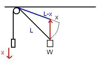

The length of the string can not change. If the vertical piece gets longer by X, the other one, connected to the weight W is shortened by X. So the end of the string has to move upward, its direction will change. See attachment.

In time dt it must be v dt closer to (each) pulley. Its net movement must be vertical. If it moves upwards distance dx and as a result is v dt closer to a pulley then dx cos theta = v dt. Thus dx/dt = v / cos theta = v sec theta.
